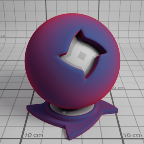

Sheen colour. This is the colour of the sheen. The sheen is generally backscattered light, seen around edges of the objects.
For example, this fabric material uses a red sheen colour:

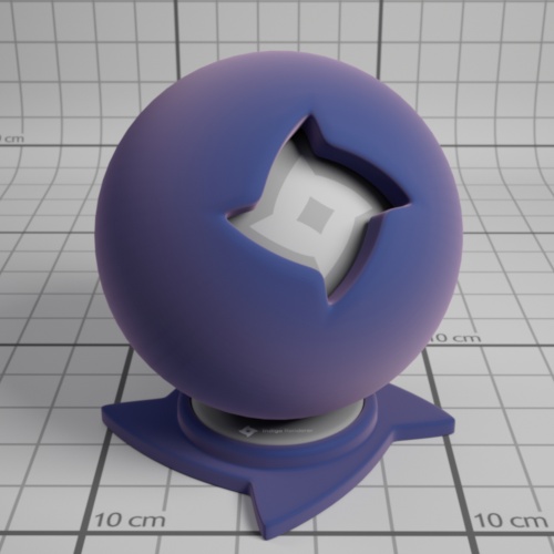

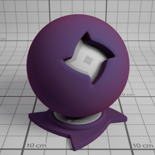

Sheen weight: This is the strength of the sheen reflection.
Sheen weight = 0.1
Sheen weight = 0.9
