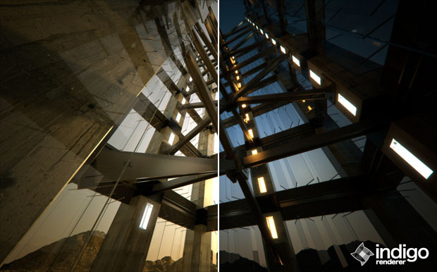

Light layers allow you to separate contributions from different lights onto different "layers". Each layer can then be manipulated separately, even after the render has completed.
You can change the brightness of each layer, or change the overall colour of each layer, or even turn each layer off completely.
