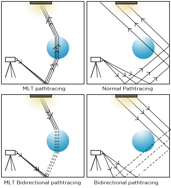

Here is a diagram describing what they do:
| Path tracing | Rays are fired from the camera, bouncing around the scene until they hit a light. |
| Bidirectional path tracing | Rays are fired from both the camera and light sources. They are then joined together to create many complete light paths. |
| Path tracing with MLT | Rays are fired from the camera, bouncing around the scene until they hit a light. When a successful light-carrying path is found, another is fired off on a similar direction. Gives good results for caustics. |
| Bidirectional path tracing with MLT | Rays are fired from both the camera and the lights, then connected to create many paths. When a successful light-carrying path is found, another is fired off on a similar direction. Gives good results for caustics and "difficult" scenes generally. |

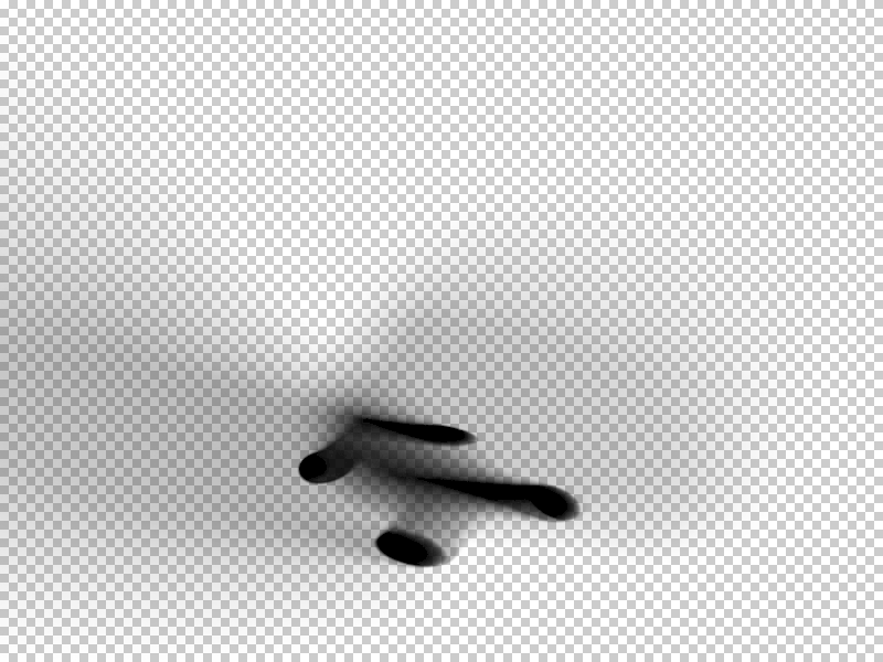

There are also other, more specialised, rendering modes available for use in post-production:
Shadows Only shadow catcher materials are rendered to an alpha layer, ready for compositing. Shadows render mode is Indigo Renderer only and is not available in Indigo RT. |
