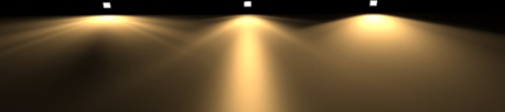

If an IES profile is selected, the distribution of emitted light is specified by the information in the IES profile. This is an easy way to get realistic emission profiles for a given light fixture, without creating a detailed model of the fixture.
Please note that only IES files with vertical angles below 90 degrees are currently supported.
