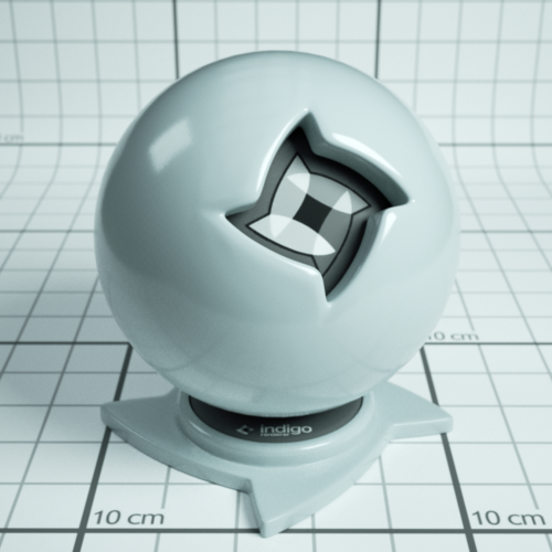

The coating material simulates a thin coating of some kind of material over another material. For example, you can create a thin coating of varnish over a metal material.
A coating material over a metal metal

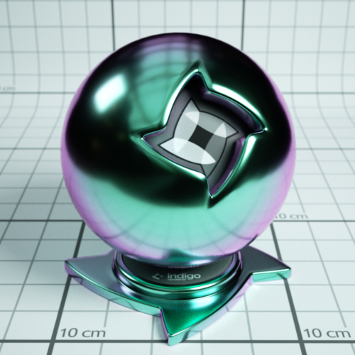

The coating material can also simulate interference, which can give interesting effects when the thickness of the coating varies with position:
A coating material over a metal metal with interference enabled. Coating thickness is controlled with a shader.

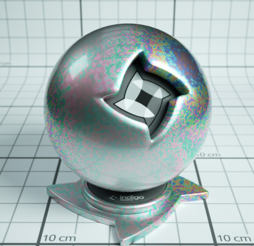

Depending on the thickness of the coating, and how the thickness varies over the object (which can be controlled by a shader) you may get a kind of rainbow effect, or the material may just take on just a few colours:
400 nm thick coating showing colours from interference.

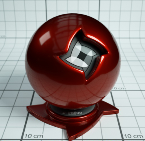

A coating can also absorb light, which will result in a tinted colour:
Coating with absorption over a metal material. The red colour comes from the absorption of non-red light as light passes through the coating layer.

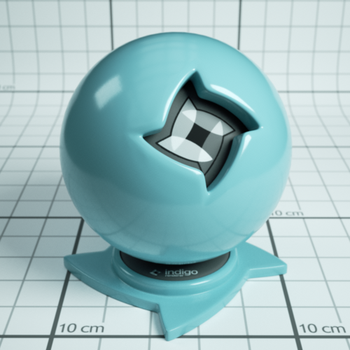

Coating without absorption

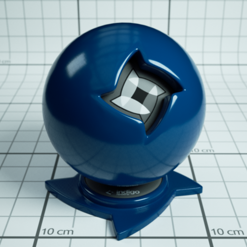

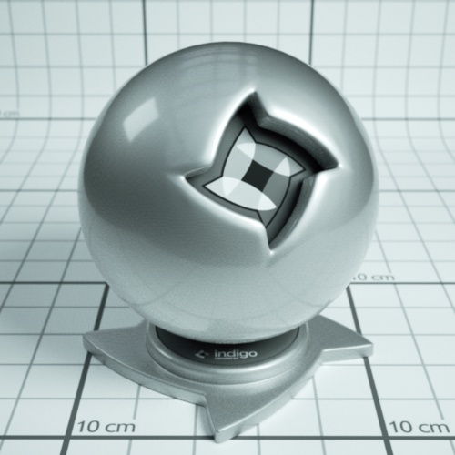

Coating without interference, thickness 0.6 μm.
