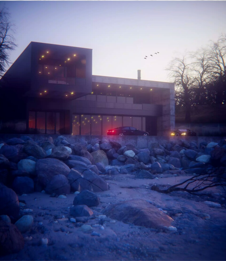

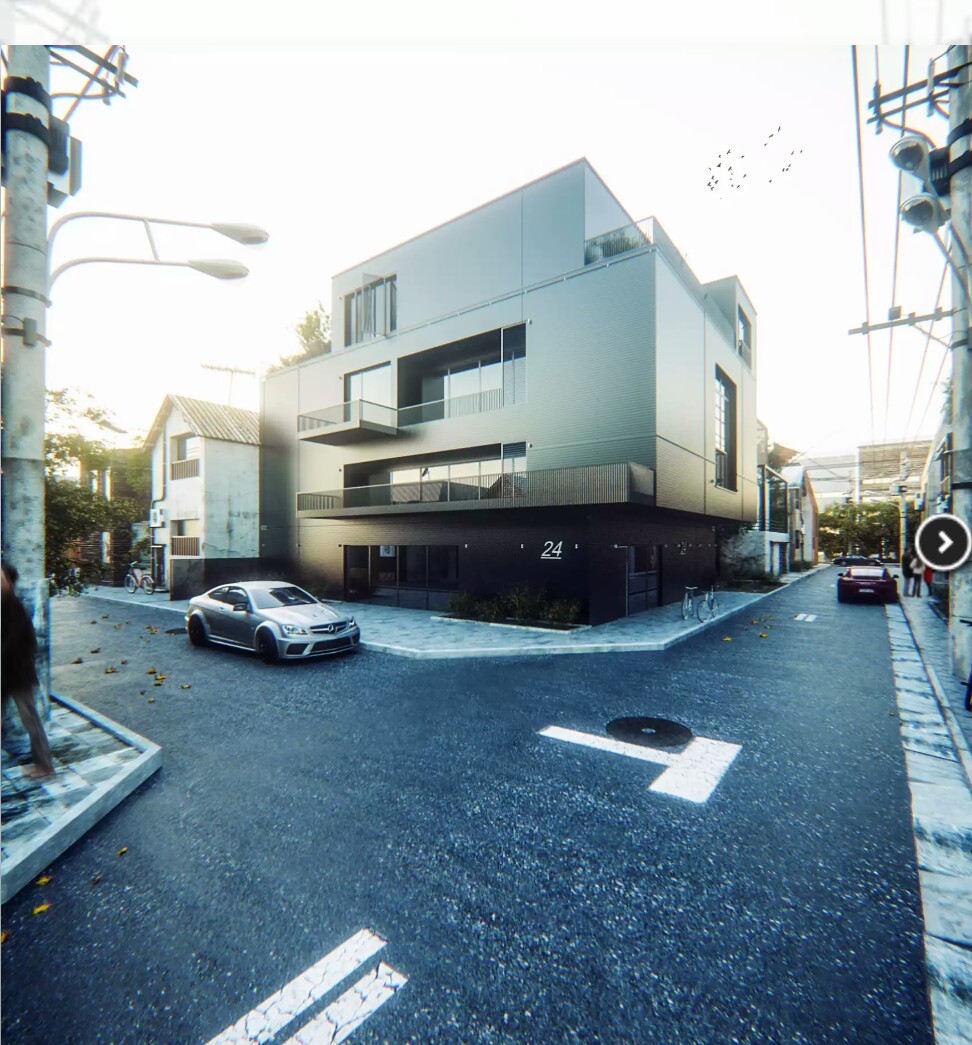

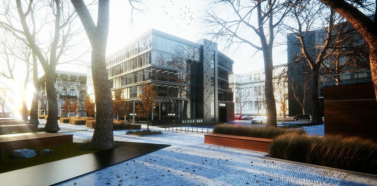

Hi guys...I was thinking that it would be nice to have some post production options...like glare, fog, chromatic aberration.. Etc, etc... The glare feature is the most important (to me) so i could have effects in the Sky and lights like the images below :
Cheers :D
