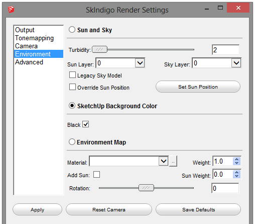

Now we will try adding a lightbulb inside the lamp and taking a night scene. Start by turning off the sun by going to Plugins → SkIndigo → Render Settings, then Environment. Select SketchUp background color and make sure Black is selected like so:

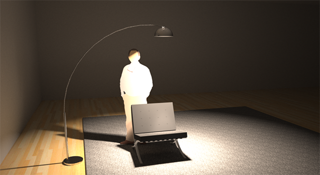

Our house illuminated from a single 5000K emitter.
