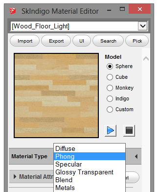

To do this, we first open up the SkIndigo Material Editor from the SkIndigo toolbar:
With the material open in the SkIndigo Material Editor, change the material type to Phong:

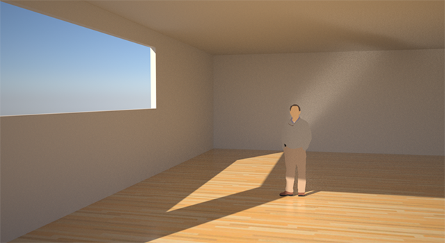

Zoom in the camera a little and hit render – your house should look like this:
Derrick in his new house with a roof, window and a floor.
