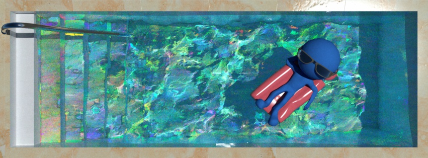

By funny colors I meant this, but it is starting to clear up after 1 hour and 4000 spp finally... looks pretty artsy-fartsy!
Re: CoolColJ's test pics thread
That happens with non uniform SSS and is will disappear over time
I'd assume you rendered that with BIDIR MLT. If you use PT-MLT the "noise" will turn monochromatic an will be less annoying (IIRC

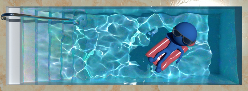

Ok ok I got it now - I remember your thread Headroom but didn't think about it. I did use BIDIR MLT, as I had the impression it would light the ground of the pool faster than PT with MLT enabled.
And I'm sure the noise will go away one day - but my impression is that the coloured noise will strive to zero while render time strives to infinity! This one is at over 40k spp, I'll stop now and continue my render without sss.
As shown, Indigo's forum is awesome. I'll leave this thread to be CoolColJ's playground again.
Interesting I never had any issues with the SSS resolving, in these water renders, it was more the dispersion (cauchyB value) which caused the rainbow look. Unless the surfaces have problem finding the sun - something that MLT variants are just not good at unfortunately with bump map and displacement

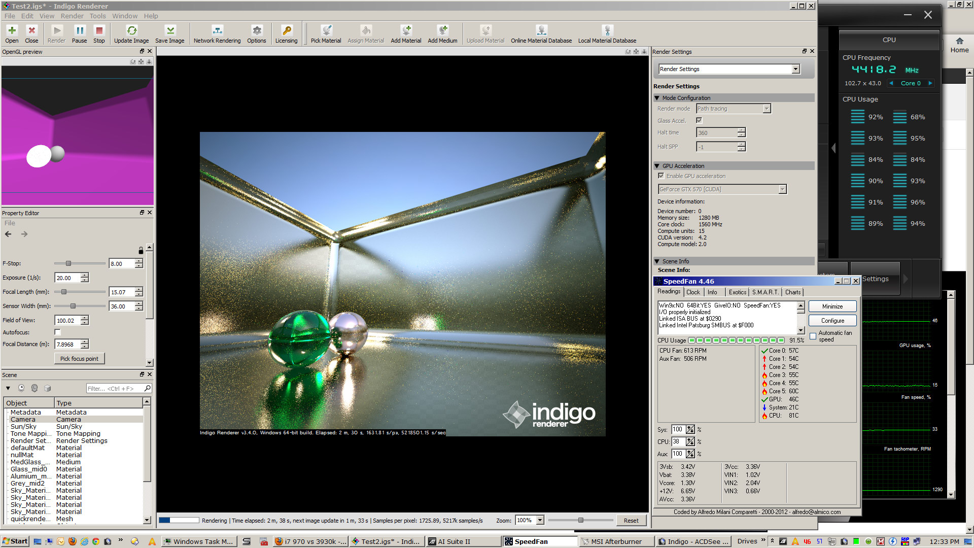

After much messing around, I finally have the system fairly smooth, except for booting off the SSD OS drive- definitely need a SP2 for Windows7...
Anyway the Intel 520 SSD is hella fast and so is the CPU
I wonder how it compares to the i7 970 running at the same clock speed - because I am thinking of getting that for my old x58 system and revert back to that, as it can run my Intensity Shuttle video capture card, which is very finicky about USB3 ports! In any case, the extra 2 cores are worth the extra $$$
Don't have much overclocking knowledge with these Ivy Bridge CPU, so I let the motherboard do most of it for me
It can run at 4.5ghz in my setup, but will crash at 4.6ghz. So I run at 4.4 with a bit of headroom for summer.
Doesn't run too hot right now in winter, I have a nice positive pressure case Silverstone FT02 - see temps in desktop pic, at 17 degrees Celsius today. Add another 20 for summer peak and it's still well under thermal limits.

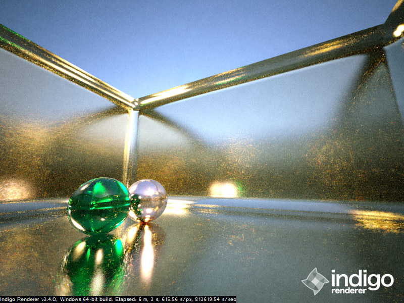

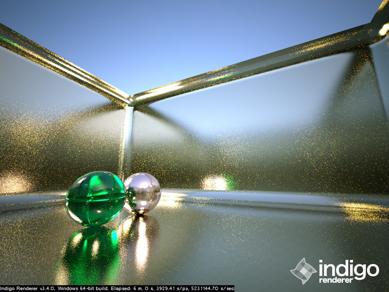

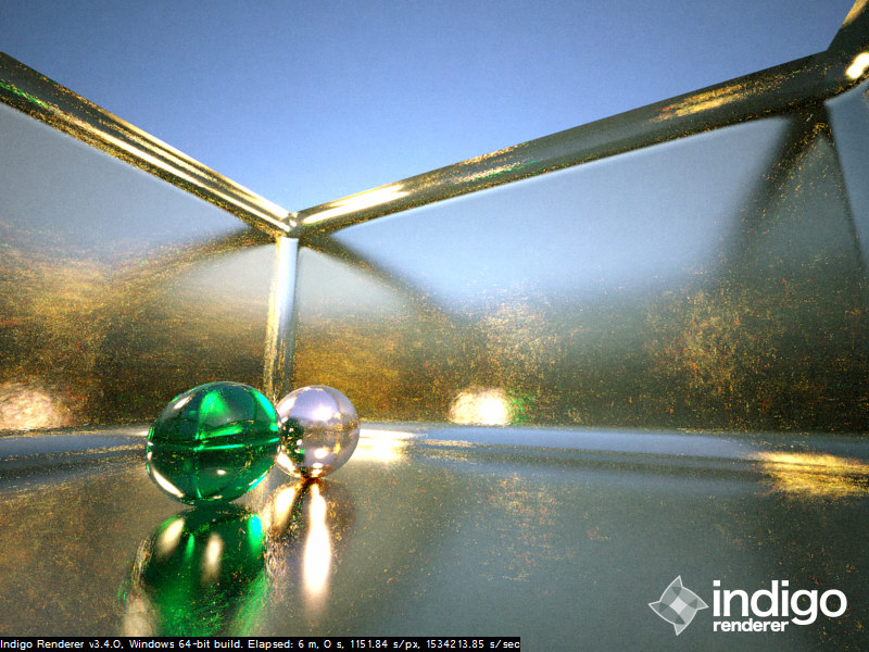

I get around 1.5 million samples/sec with the Pins test scene that comes with Indigo, running at 4.4ghz on the 3930k CPU.
With a simple outdoor scene, it flies, see pics below. The scene needs MLT to render well, as it has lots of reflections/caustics and has physical aperture diffraction.
The first few passes go by so fast, it's like a pure GPU renderer!
I would say it's pretty close to double the speed of my i7 930 running at 4 ghz....
All rendered for 6 mins each.
GPU mode over 5 million samples - doesn't tax the GPU too much even then... 46% GPU load Path tracing 3.6 million samples - fast, but slow
MLT - fairly high sample rate, and overall convergence, but not as accurate as BMLT
1.5+ million samples Bidirectional Path tracing 1.6+ million samples Bidirectional MLT - the slowest smaples wise, but the fastest converger here 813+k samples
Just tried v3.4.2 - and it's even faster across the board!
ie a BMLT render I'm doing now went from 800+k to 1000+k samples per second
edit - looks buggy though, no apeture diffraction happens....
edit2 - it looks like there is a bug in the Indigo renderer, when your tweaking the F-Stop, while the renderer is running. The render updates, and the exposure changes, but the value you enter doesn't reflect the render results of the aperture dispersion. because when you save the scene, quit, and reload Indigo+ scene, it renders differently

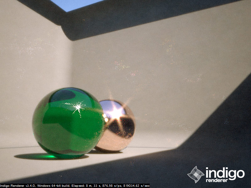

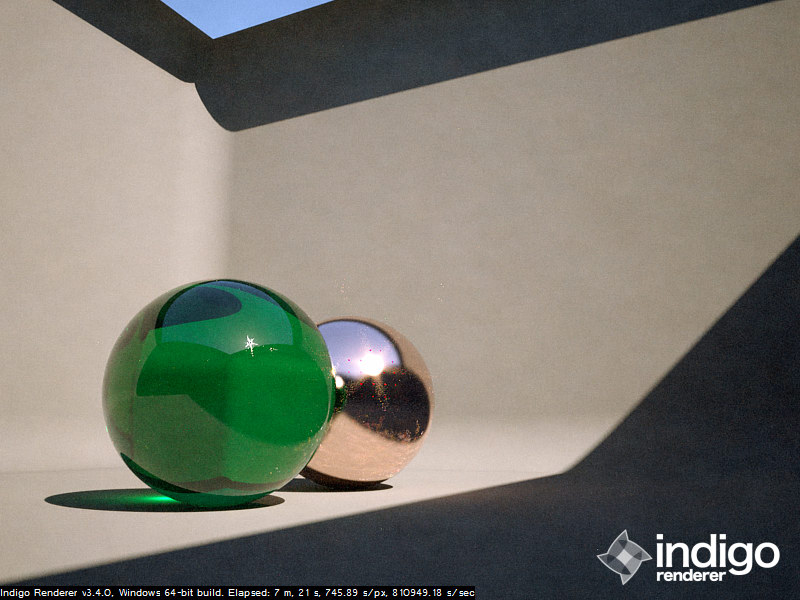

here are the bugs
v3.4.2 no diffraction and what are the red dots? v.3.4 aperture diffraction with F16 on lens - red dots as well Here I entered 128 into the F-Stop in Indigo, by typing it in, and then typing in 16 again to return it to the above scene, but it renders like it's at F-Stop 128, but with F16 exposure values. And you get this garbage on the walls
If I drag the F-Stop slider back to 16 then it seems to nullify the bug - it seems to happen with a few other values in Indigo as well, dragging the slider vs typing it in.
edit - it does seem to me Indigo does not has as much aperture diffraction as a real camera with the same settings. I mean having to go up to f128 to get them isn't exactly realistic
see what I mean?
real camera have way more diffraction at the same fstop as Indigo - me thinks the simulation needs tweaking
- Posts: 1828
Could be because it's a shitty lens, thoughCoolColJ wrote:see what I mean?
real camera have way more diffraction at the same fstop as Indigo - me thinks the simulation needs tweaking![]()
Hi CCJ,
Can you please post (or email us) the scene with the red dots?
Non-post pro aperture diffraction is broken in updated bidir, will fix.
i noticed problem with AD too when using Image
Maybe that (sadly still not released) Paper could be a good starting point:CoolColJ wrote:real camera have way more diffraction at the same fstop as Indigo - me thinks the simulation needs tweaking
Polynomial Optics: A Construction Kit for Efficient Ray-Tracing of Lens Systems
