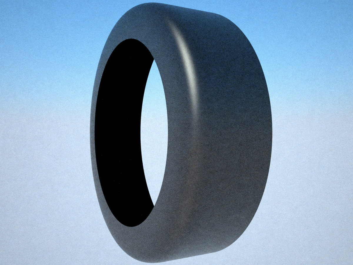

I'm not sure if this is a blendigo issue, but I'm trying to make a wheel, and have some weird issue with the bump map.
I've made a quick mesh from scratch with the same problem.
Blender 2.49a (same with b), blendigo 2.3.1, indigo 2.2.
Blend: http://www.home.no/faenskap/wtf.blend
Bump map: http://www.home.no/faenskap/yokobump.png
What the fish is going on? Check the attachments.
With subd enabled in blendigo, ok except some bump map weirdness.
With displacement map, looks funky too.
With bump map.
Render without bump map, all ok.
Wire, highlighted faces is UV layout.

The point was to show what happens to the rest of the mesh, not the displacement.
I'm talking about the weird pattern when using only the bump map.
Every face gets a circle on it when rendered.
Here's some high geometry renders.
Blender modifiers applied.
Subd smoothing off in blendigo.
Wire with UV layout.
Bump at 2mm. Same sized circle pattern.
Displacement .006, corner smooth. Probably not enough faces for this texture, but should it affect faces outside UV layout?

Post by Meelis » Fri Feb 05, 2010 5:51 am
:? This pattern goes like 1 per 1 face.
What if u lower bump value <b>0.0001</b> <b>0.001</b>
Is the bump over sides or the whole tire, is there multible materials for same faces (under F9), delete those what's not assigned.

I think blenders default uv-mappping is to have full image for each quad. As you haven't uv-mapped the rest of the tire, each quad has the whole circular bump-map you've made for the side.
You'll need to unwrap the whole tire to get rid of those circles.
Here's an example

Ok, that's it.
I forgot that I deleted one of the materials to try with only one on the whole tire, without unwrapping the whole thing, then updated blendigo, then wasted a whole day on this, then.... :oops:
