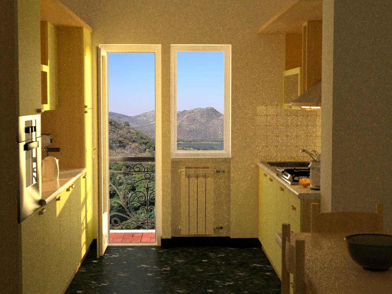

Post by delle » Tue Nov 18, 2008 9:39 pm
Hi, this is my kitchen...
Bye
Delle
Day version
Night version
Post by Pibuz » Tue Nov 18, 2008 10:43 pm
Hi Delle!
Interesting work! Congratulations!
I think the radiator area is really GREAT, and the cooking plane good enough.
I'd rather work a little more on the shaders of the furniture, it all seems no reflective at all, and that is not real..
The objects you used, instead, are really good!
Overall, a nice work for me!

Post by Photoguy » Tue Nov 18, 2008 11:47 pm
Cute kitchen!
Although someone left the door open, and some fireflys got in. :wink:

Post by ROUBAL » Wed Nov 19, 2008 10:36 am
Nice render ! Well done.

Post by suvakas » Thu Nov 20, 2008 2:57 am
Hmm..so full of fireflies.
What is your Super Sample Factor parameter set to?

Post by seregost » Thu Nov 20, 2008 5:51 am
Good work, i like it, but I think you haven't this view from your kitchen :lol:
Pay attention to alpha channel :D

Post by rgigante » Thu Nov 20, 2008 6:47 am
Hey Delle,
are your light source covered with specular transparent materials? This could be the source of the fireflies... imho

Post by Zom-B » Thu Nov 20, 2008 9:58 pm
Hey Delle, here just my 2 cent:
Do U use Exit Portals for the balcony? This should speed up the scene (less fireflies!)
The metal thing on the balcony seems to e an image with alpha map.... the white border isn't very nice, take care not to use step blend option if you alpha map is not pure black/white...
Did you used the render alpha foreground option of Indigo to get a mask for the sky? If not, give it a try, it renders super fast ;-)

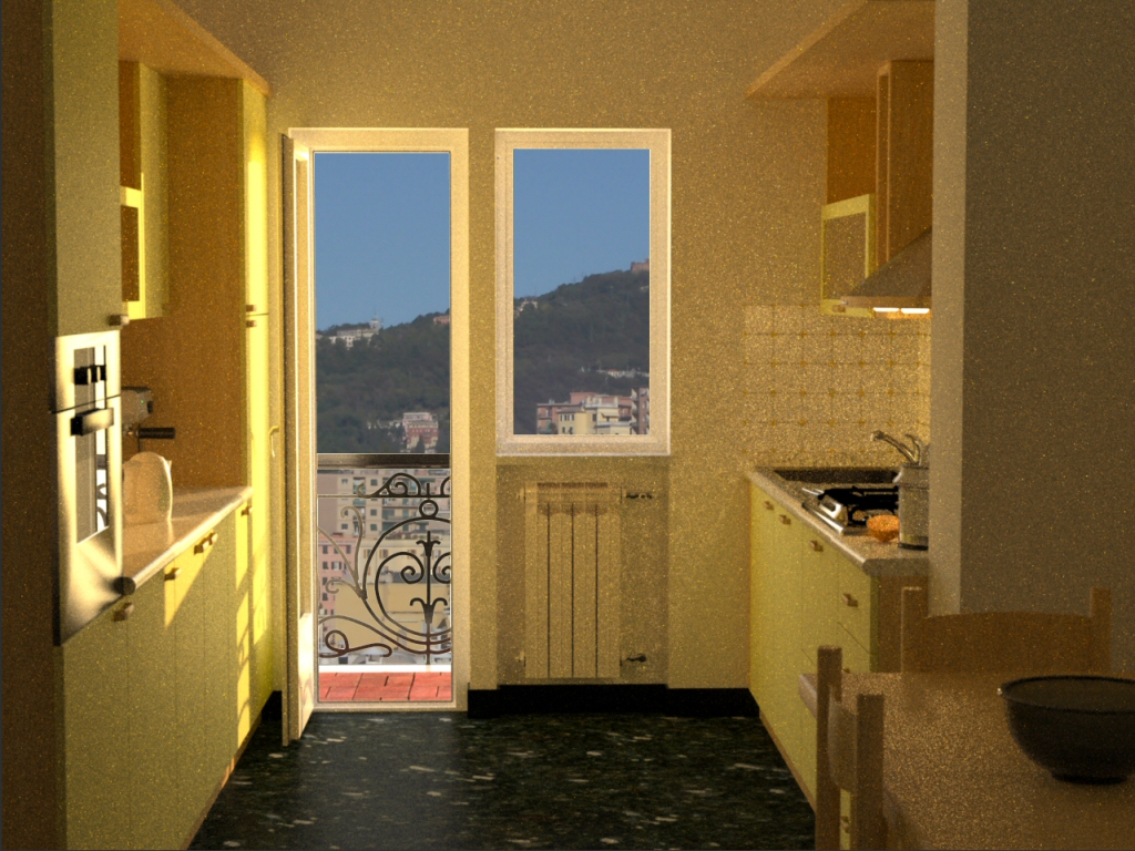

delle
Posts: 175
Location: Italy
Post by delle » Thu Nov 20, 2008 10:36 pm
No, if I use exit portals the terrace disappear :wink:
I've used the "Magic wand" tool of PSP 8 that's why there is the border...
Could you explain in detail?
P.S. Here is another version with the real background (Genoa - Italy)
Bye
Delle
Post by Zom-B » Fri Nov 21, 2008 4:29 am
He he.... nobody ever said that a Exit Portal has to be a simple 2D plane ;-)
Just make a box shaped Exit portal with no wall to your scene (normals facing inside!) so your terrace is stil infront of the Exit Portal!
Its slower than simple 2D plane, but should be still lot faster than without exit Portal!

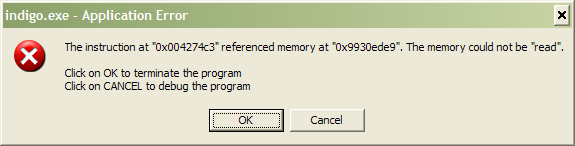

Post by delle » Fri Nov 21, 2008 5:06 am
It causes a Crash to Indigo (v1.1.14)... :shock: :shock:
Here is a simple scene that causes the crash (IndigoCrash.igs)...
If I eliminate the line...
<render_foreground_alpha>true</render_foreground_alpha>
... it renders well (see picture im1227199955.png)
Bye
Delle[/quote]
IndigoCrash.igs
(4.77 KiB) Downloaded 236 times
