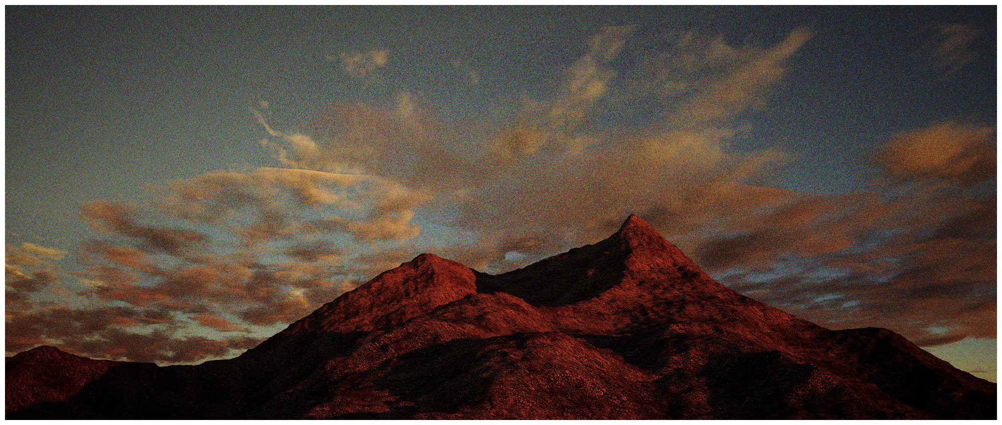

Another kind of approach. With a predisplaced terrain from satellite data and premeshed clouds to help composition. First attempt. I decide to stop it at 1000 spp because the speed decrease ...
Is the peak of the Mount Ruapehu, a volcano in New Zealand. It is supposed that there must be snow.
A impression then.
A impression then.

Those clouds look sexy, but there are some visible edges there taking the realism off. The mountain needs work.
Keep it up!
Keep it up!

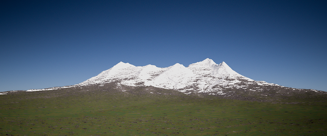

A general take with one material. It begins to be something, a mix of some ISL codes and some maps.
I forgot that I´m not able to do fbm´s displacements, but bumps do it in a strange mode.
I feel a lack of modularity in the general shape but here goes.
To progress something in it I must do a lot of ISL questions.
Now I have zero time, sorry. For more over...

Now those are nice mountains.

But there is a bug working with slope and ISl. I´m not able to displaced the snow (only bumped).
Now I need to know from where this image become: I don´t remember how I obtained this image. Is reduced and banded, but more or less...
I believe that all the surface of the Earth is well mapped, but where can i find it?

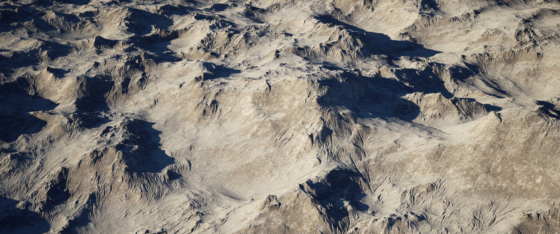

Re: Landscapes
A wip test with 37 million of instances. 21 GB of ram used...

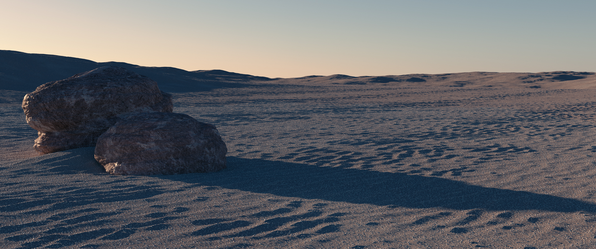

Re: Landscapes
awesome

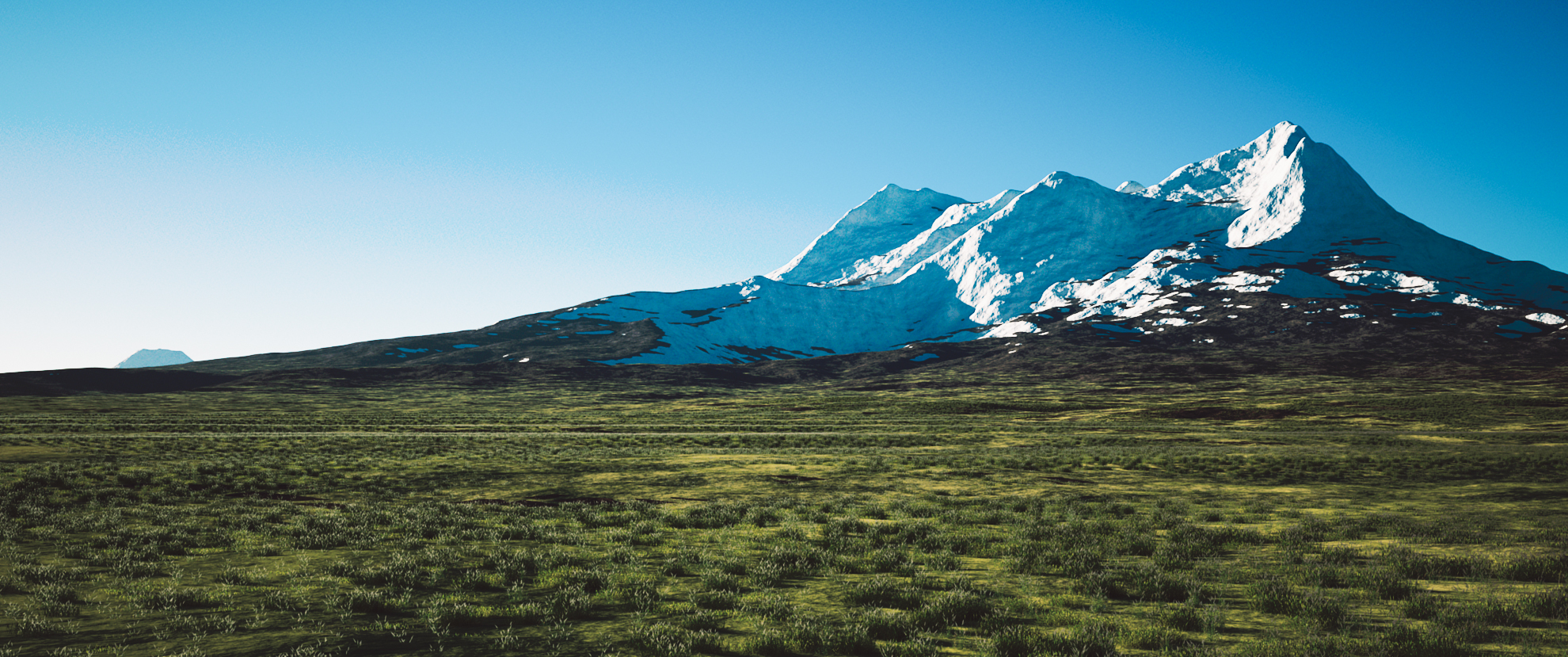

New tools in Houdini 16 for terrains.
3 min. render.
134+ Millions of unique triangles. 2x2 km.
3 min. render.
