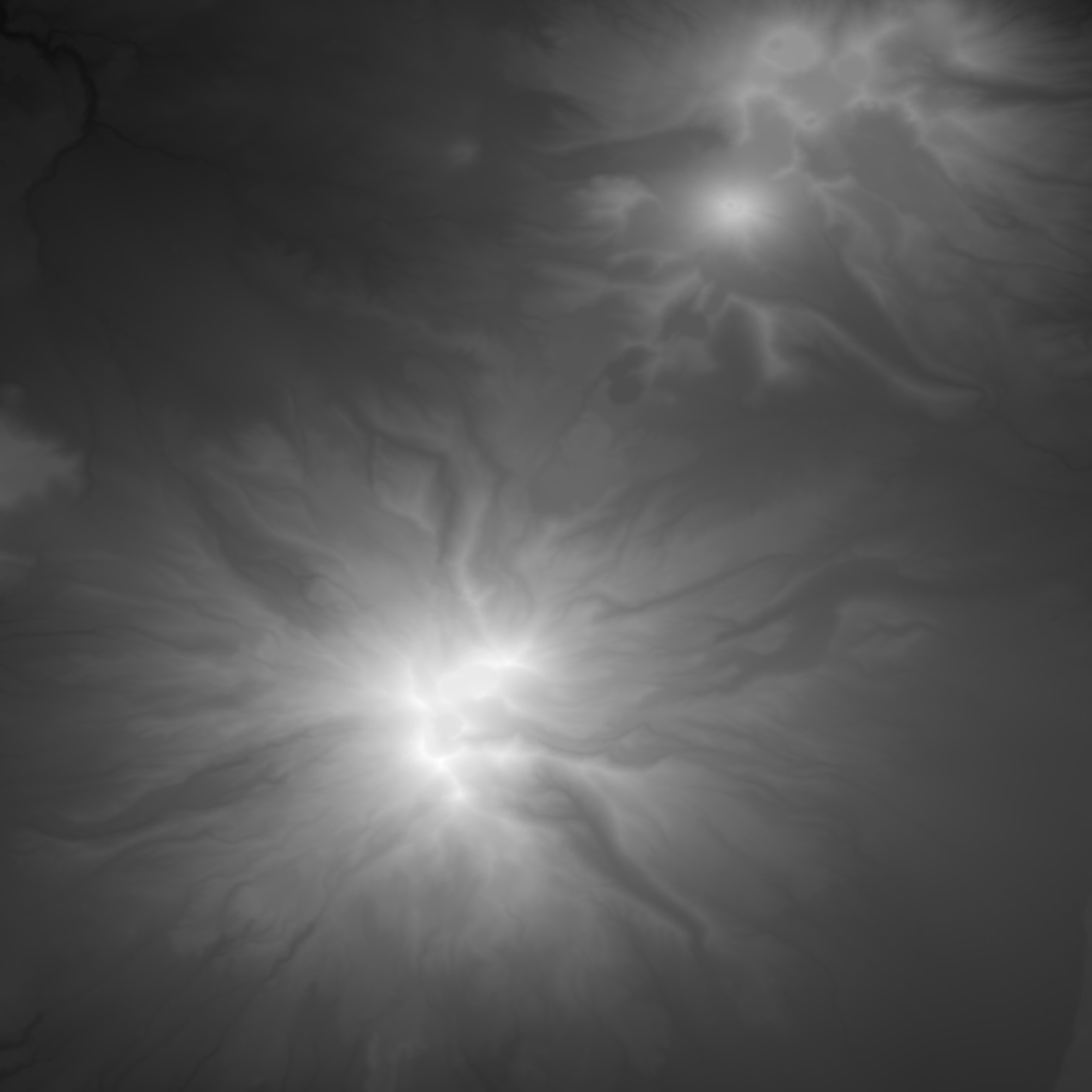

Now I need to know from where this image become:
I don´t remember how I obtained this image. Is reduced and banded, but more or less...
I believe that all the surface of the Earth is well mapped, but where can i find it?
