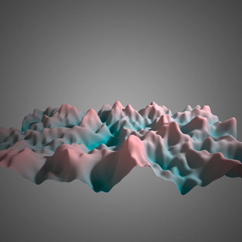

This is an example of Perlin noise used as a displacement value:
Returns single-valued (scalar) Perlin noise evaluated at x. Values returned lie in the range from -1 to 1.

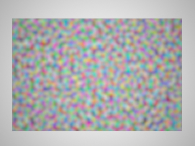

An example of 3-valued noise.

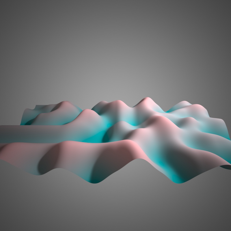

FBM, 1 Octave of noise.

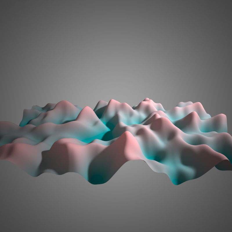

FBM, 3 Octaves of noise.

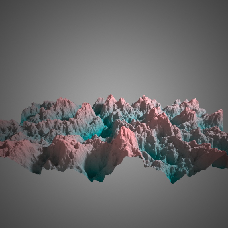

FBM, 10 Octaves of noise.

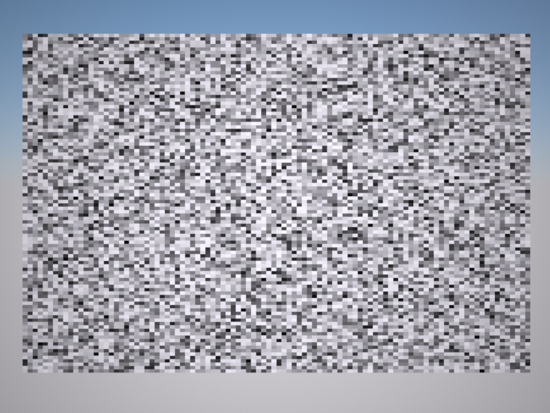

Takes the floor of the coordinates passed in, and then returns a quasi-random value between 0 and 1 for those integer coordinates.
Grid noise.

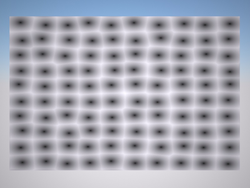

Voronoi noise
Returns the coordinates of the nearest Voronoi site.
The irregularity argument controls the 'randomness' of the site positions. It should lie in the range [0, 1].
Irregularity of zero corresponds to a regular grid of site positions.
Irregularity of one corresponds to the maximum 'randomness' of cell positions within the grid, so that the grid is not visible.
A shader based on Voronoi noise. The white value of the shader is based on the distance in UV space from the shaded point to the nearest Voronoi site. Irregularity = 0.2.
