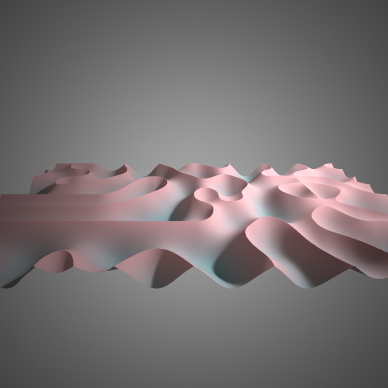

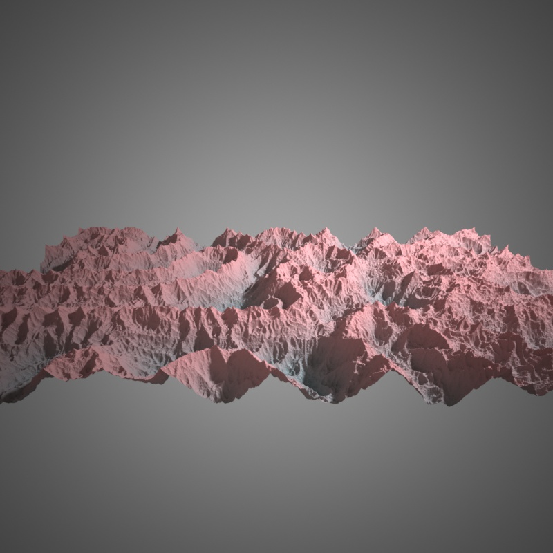

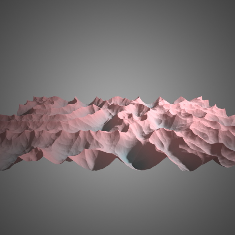

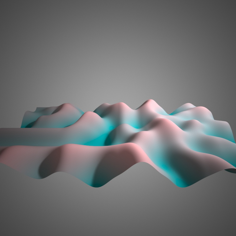

Perlin basis, 1 octave
Perlin basis, 2 octaves
Perlin basis, 3 octaves
Perlin basis, 10 octaves

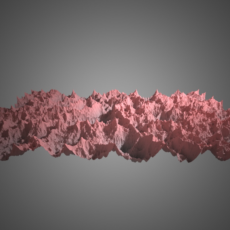

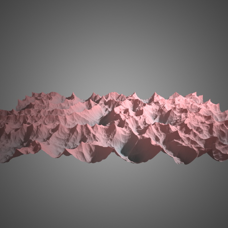

Ridged basis, 1 octave

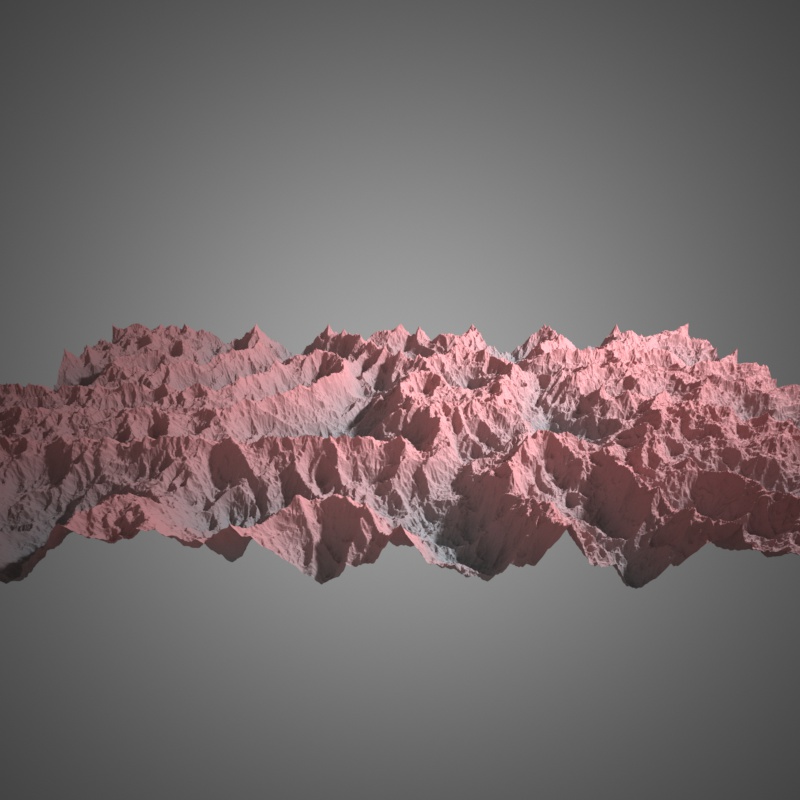

Ridged basis, 10 octaves

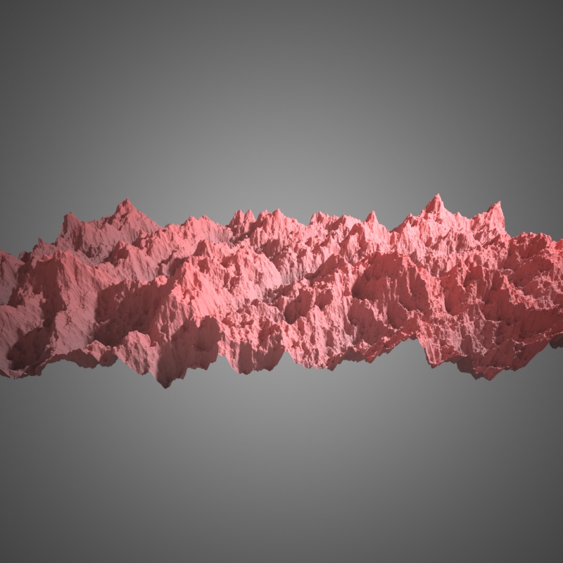

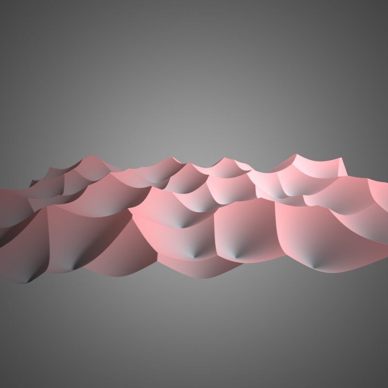

Voronoi basis, 1 octave

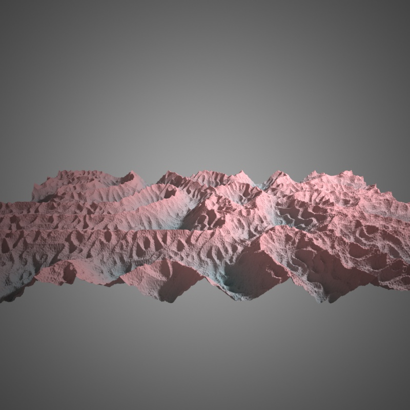

Voronoi basis, 10 octaves

Ridged basis, H=1
Ridged basis, H=1.5
Ridged basis, H=2
