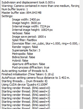

Hello Zom-B,
Yes I have sufficient space. I start the render and everything is fine up until I try to save image...
Left a render to work through the night, came back this morning and still same problem...
Here's a screen capture with Render log.
Thank you very much for taking the time to help me solve this problem.
Kind regards,
Alejandro

Re: Help needed : Indigo not responding (Skindigo RT)
Post by Zom-B » Fri Mar 20, 2015 7:51 am
Don't use GPU rendering, that should fix your issue!
Post by Alejandro_66 » Sat Mar 21, 2015 5:45 am
Zom-B wrote:Don't use GPU rendering, that should fix your issue!
Hello Zom-B, So far that seems to work! Thank you!
