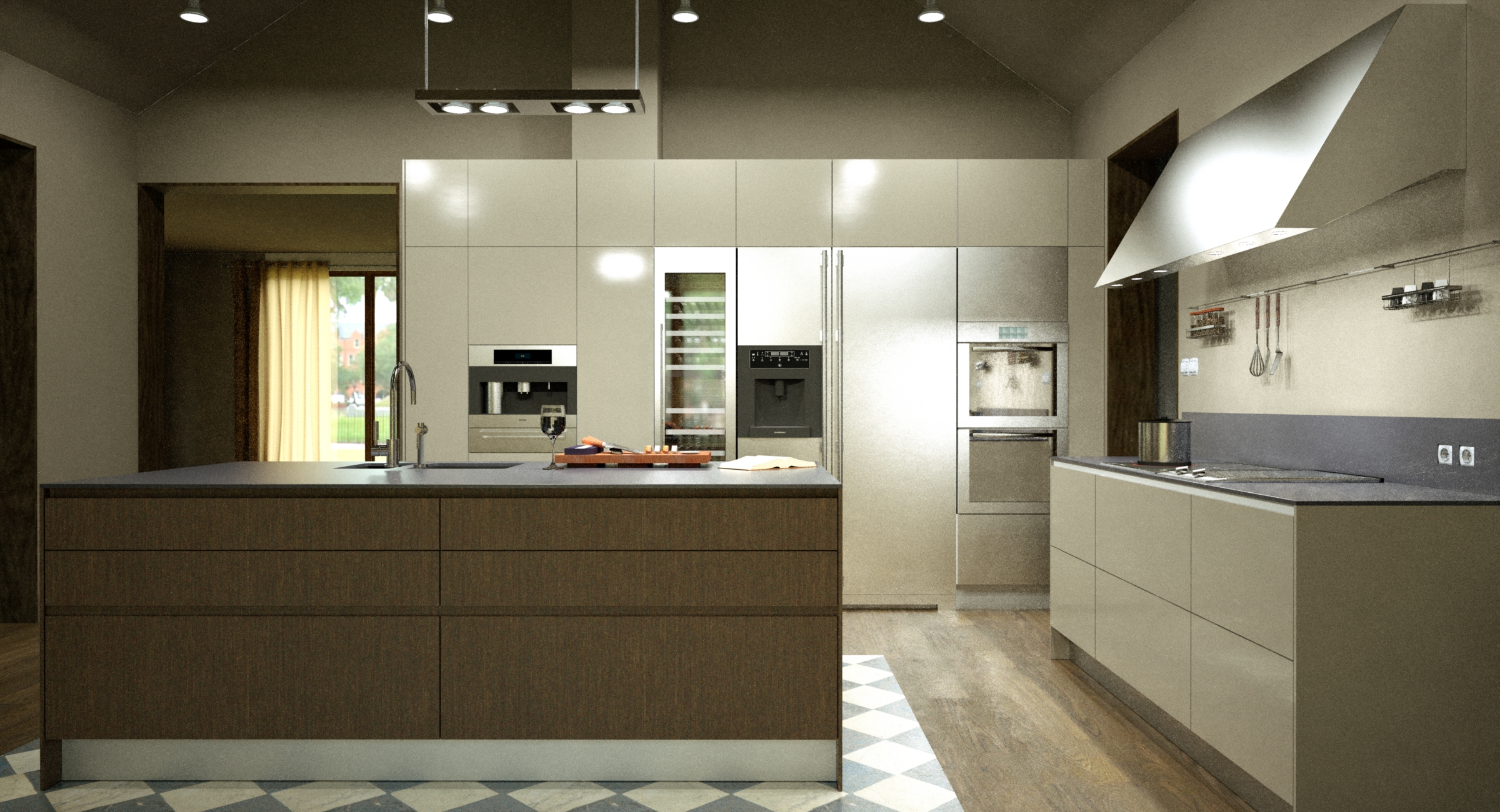

Hi!
The first one is the kitchen - unfinished yet. I see few mistakes (hood should be more beveled, some changes to materials).
Please have in mind, that I've saved this image and closed the renderer (and not saved!) without any postpro... Out of the box.
Feel free to comment.
BiDirMLT, HDRI env, 2400x1300, ~8500 samples per px and still much noise... :/ Should be better right?
What about these white lines on the ceiling?
thanks,
m.

Post by CTZn » Sat Jul 17, 2010 10:56 am
Give your walls a thickness... or, put exit portals at the window (mandatory for say) !
It's looking pretty good mily !
edit: out of curiosity, wich Indigo version are you using ?

Post by mily » Sat Jul 17, 2010 11:14 am
Thanks CTZn!
That's why I haven't got problems with the white lines until now - I've been using portals and ceilings were horizontal :)
I'm using the newest 2.4.6 beta.
And what about the rendering time/blur/noise? I'm trying to minimalise it as I can (even the glass on the counter is ghost)... Could it be faster/cleaner? My i7 cooked it ca 300 s/px for 12 hours.

Post by CTZn » Sat Jul 17, 2010 1:15 pm
Well, adding portals should substantially increase performances. The fastbox splat filter has shown to deal well with noise (2.4.6), I'm wondering what would the result be with GPU only. Myself didn't stress gpu much yet.
But first, portals all the way.
Are you using layers ? There was that trick to tweak light energies in order to have their efficiency matching with the other light sources...test-render each lighting types separately, and augment the power of those generating perceptibly more noise before launching the final render.
We should make a tutorial on this advanced tip, before it gets automated somehow.

Post by mily » Sat Jul 17, 2010 10:43 pm
CTZn wrote:Well, adding portals should substantially increase performances. The fastbox splat filter has shown to deal well with noise (2.4.6), I'm wondering what would the result be with GPU only. Myself didn't stress gpu much yet.
I'm doing test with the fastbox. Seems to have good results.
I'll try the GPU and add better roof :)
Unfortunately I have to use background image (HDR this time) so portals won't work, right?
CTZn wrote:Are you using layers ? There was that trick to tweak light energies in order to have their efficiency matching with the other light sources...test-render each lighting types separately, and augment the power of those generating perceptibly more noise before launching the final render.
I read a topic about this method, but I don't have much time for such tests. Tutorial would be great in the future!

Post by Pibuz » Sat Jul 17, 2010 11:56 pm
I think portals would work too! After all, they're don't delete your light sources, and you have an environment map emitting light so... 8)
Portals and GPU could accelerate the calculation: unfortunately you will be able to use only PT, which you know is not the best solution for interiors, afaik.

Post by lycium » Sun Jul 18, 2010 12:26 am
I would suggest not using MLT on this scene, straight bidir should be a winner. In the topleft corner are some light leaks, caused by surfaces without thickness; which version of Indigo was used?
Really nice scene though :D

Post by mily » Sun Jul 18, 2010 2:03 am
Pibuz wrote:I think portals would work too! After all, they're don't delete your light sources, and you have an environment map emitting light so... 8)
That's great news Pibuz! Works like a charm!
I thought the portals only work with sun/sky env...
GPU PT is faster, but in this scene, where almost everything is phong, MLT gives better results (e.g. fireflies in PT). I'll do some testing though.
lycium: You're right, the ceiling is plane only... Thickness solved the problem.
Zom-b: I'm using newest indigo 2.4.6. I didn't had leaking till now, when client wanted env. Previously I was using only portals+sun/sky.

lycium wrote:I would suggest not using MLT on this scene, straight bidir should be a winner. In the topleft corner are some light leaks, caused by surfaces without thickness
Question 1 for Tom: I knew MLT was best for interiors!
Moreover, the SkIndigo query does not include straight BiDir, but only BiDir MLT or BiDir PT..
Question 2 for Tom: the light leaks through non-thick walls was an old issue I found with an ancient version of Indigo (the first which supported the sun/sky layers splitting), which you guys fixed in a glimpse btw. I suggest you put this on your todo list again. I don't think you will find any problems, and will make A LOT of SkIndigoers very happy 8)

Post by CTZn » Mon Jul 19, 2010 1:36 am
BiDir PT
That's the one Pibuz.
No bidirectionality without path tracing, as the first is an extension of the second ;)
