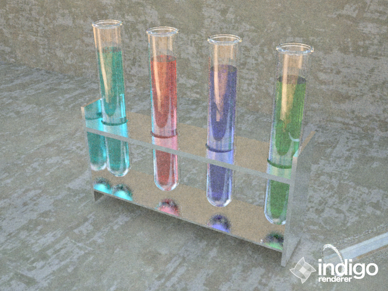

Post by neo0. » Thu Sep 04, 2008 9:30 pm
Inspired by inject, allthough, its nowhere near as good. :(
Using exr lighting.. I'de appreciate any advice on making it look more realistic..
Post by PureSpider » Thu Sep 04, 2008 11:43 pm
Don't make the tube holder THAT reflective...
Maybe a lower exponent will do!
And put it to the ground :D
Then, let it cook longer and we will see where that will take us ;)

Post by lar111 » Fri Sep 05, 2008 12:18 am
Hey Neo, thats looking like a good start.. Got a couple of suggestions for you.
1 ) the shelf of the test tube holder, make a second shelf like that and place it below the first.. So you have two sets of holes for each test tube, it will stop the tubes from sliding out of the holder.
2) have the tubes resting on the bottom, at the moment they are floating in the holder, test tubes usually have straight sides so the would slip all the way in until the are touching the bottom
Oh and one last suggestion, maybe put a small mesh light in the scene ( you will have to try and match the poser with your exr), see if you can get some caustics, but thats more a personal preference
Post by Kram1032 » Fri Sep 05, 2008 2:15 am
Ior of glass is ~1.5... That should be the correct reflectivity.
Exponent should be pretty high, as otherwise the liquid will get blurry or the glass itself will even look like sanded...
(Or you use a Specular, where you always have perfect reflections)
Post by pixie » Fri Sep 05, 2008 2:51 am
Specular and exponent, since when?? Otherwise how to get transparent phong?
Post by PureSpider » Fri Sep 05, 2008 3:50 am
Huh?
You can use exponent for glossy transparent... that is "transparent phong"

Post by MSUdom5 » Fri Sep 05, 2008 3:57 am
Looks good!
To get the scale to look right, you also might want to consider adding a meniscus to the contents of the test tubes.

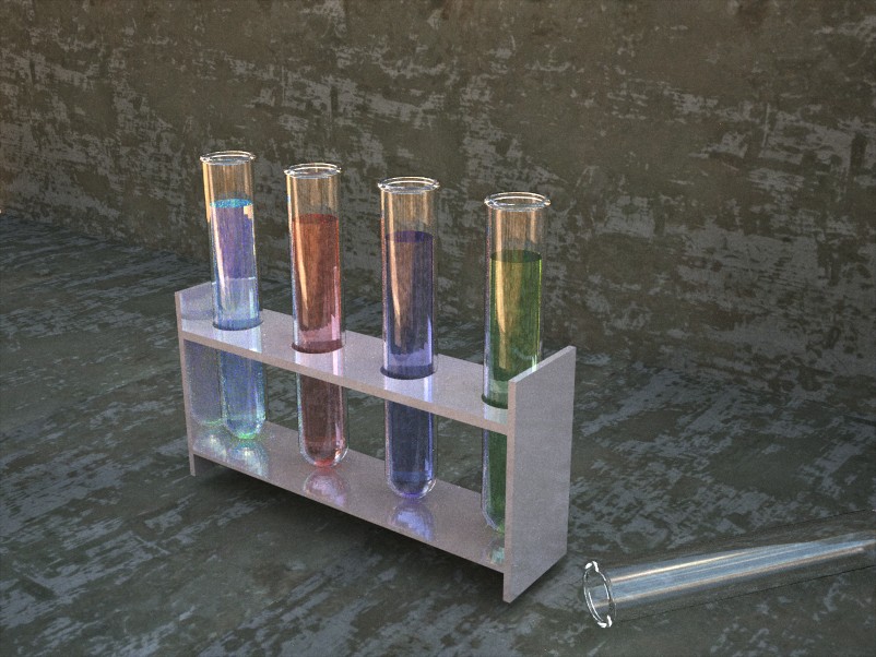

Post by neo0. » Fri Sep 05, 2008 8:55 am
New versoin, a bit of post pro in violet
Post by CTZn » Fri Sep 05, 2008 10:24 am
Quite good, the image lacks a bit of contrast imo (medium tones too bright). A meniscus is the deformation of the water surface around the tube.

Post by crojack » Fri Sep 05, 2008 11:35 am
Hey neo, why is everything always floating in your renders?
it doesn't hurt anything if surfaces are touching in sketchup/skindigo/indigo.
looking better though!
could use some sort of context, a desk or some sort of background or something.
Post by neo0. » Fri Sep 05, 2008 6:45 pm
Any idea how I could fix the issue w/the midtones?
Personally, my issue is that the glass looks too plasticy...
Post by PureSpider » Sat Sep 06, 2008 12:08 am
Different tone mapping and/or different environment map
Post by CTZn » Sat Sep 06, 2008 3:04 am
Well now I'm seeing you image in a daylight situation and contrast is not really an issue, some times I'm a bit picky :oops:
