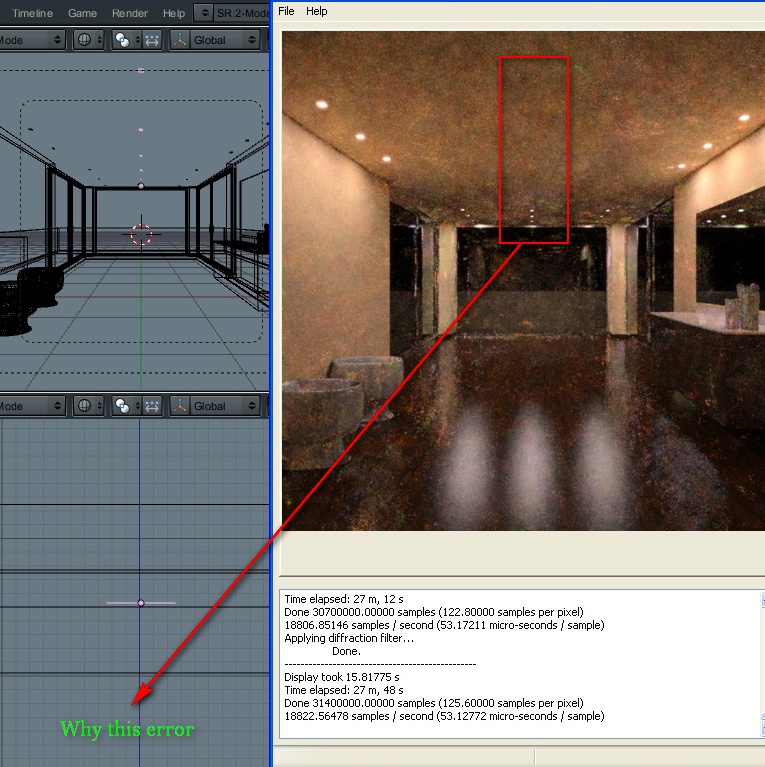

I don't know if it is my fault or rather Indigo or Blendigo, but if I apply the modifier Array with 6 copies I can not see more than three example of the middle row of lights.
Thank you
Luca. ;)
Google Translate
Post by StompinTom » Sat May 24, 2008 9:21 am
thats cuz youre probably using a copied object with the array modifier so its referencing the first copy which probably has an array modifier with only 3 lights or whatever. you gotta duplicate it. a bit of a bitch, especially when youre changing the arrayed object a lot or tweaking it, but it applies the modifiers when exporting and since that same object is referenced again, you cant have multiple arrays for the same object. follow?
usually best to do individual instances then instead of arrays in that case.
itd be cool if the exporter could pick up the array modifier and instead of applying it, get its translation/rotation/offset info and make instances like the array actually does.
i hope you get what im saying....

Post by Pinko5 » Sat May 24, 2008 9:38 am
ok StompinTom probably i copy the first plane (ALT+D) and then i apply new array...i try with your suggest...asap
Tnx
Luca. ;)
Ok Stomp i try immediately and you are right now it works fine!!!
Tnx again... :D
