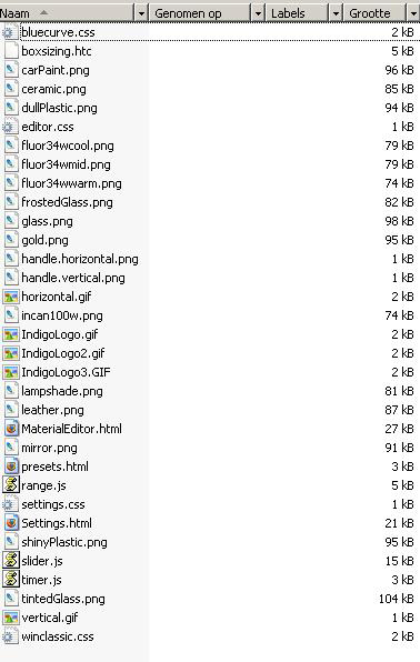

I uninstalled previous versions of Skindigo before getting the newest one.
[EDIT]: I attached the screenshot images.

It looks like the unzip program did not create the sub-folders.
For example, I have a folder called "Dialogs" and the three indigologo .gifs when I first open the skindigo folder, and than further sub-folders in the dialogs folder.

crc wrote:It looks like the unzip program did not create the sub-folders.
umm..I think he is probably using the updated version that does not contain any sub-folders. I can't tell because I haven't seen the posted images yet! My damn office network blocks the Photobucket links! :roll:

oh, sorry. Didn't realize that there was a version without the subfolders. :oops:

Post by kwistenbiebel » Thu Nov 15, 2007 11:38 am
Hi Whaat,
Yes I am using the latest update of Skindigo.
I uploaded the screenshots instead of linking them from photobucket.

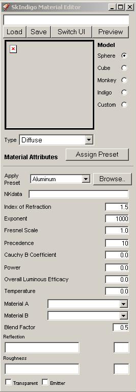

On another note, the screenshot of the mat.editor (Kwisten's) is different, other than the way it looks. I know that there are problems with the sliders, etc. but I can't get all those options to come up, sliders or not, with either of the UI's.
This is what I get, for reference.

Post by Whaat » Tue Nov 20, 2007 5:46 am
Hey crc,
Certain attributes are only visible based on the type of material. Not all attributes are available for each material type. If you try each of the material types you should see all of the options shown on biebel's screenshot at least once.
Your screenshot looks like it should.
