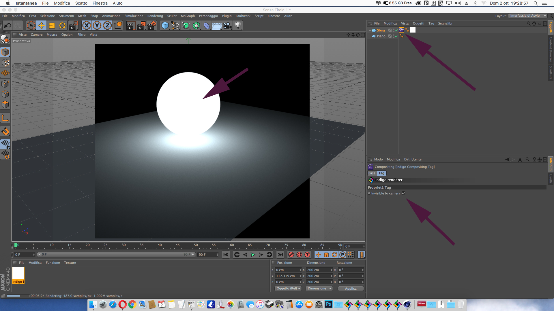

Re: Indigo for Cinema 4D 4.0.43.2
Composition tags don't work here...; C4D R13, 15, 17
- Originalplan®
- Posts: 757
- 3D Software: Cinema 4D
Composition tag works by me. Section planes don't.
@contegufo try rendering with the render button and not via Render Region.

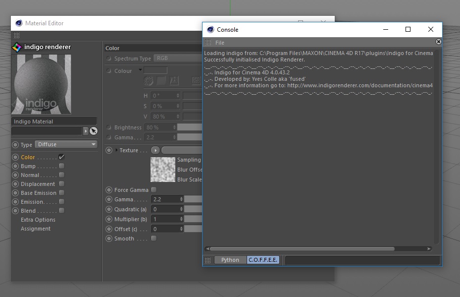

Sorry for wrong info: when i install new ssd driver, it does not work on both GTP and MBR, my bad:(hi all, maybe I have found the answer why Cidingo (4.0.42->4.0.43.2) not bake any C4D shader (or may not, I'm not sure). When using Windows on GPT UEFI, the error occurs, if windows10 run on MBR then Cidingo work fine.
Hey dp3d,dp3d wrote:Sorry for wrong info: when i install new ssd driver, it does not work on both GTP and MBR, my bad:(hi all, maybe I have found the answer why Cidingo (4.0.42->4.0.43.2) not bake any C4D shader (or may not, I'm not sure). When using Windows on GPT UEFI, the error occurs, if windows10 run on MBR then Cidingo work fine.
can you check the c4d console if there are any errors that hint at why it fails to bake the textures?
hi fused!
I don't know much about using console, here what I got. And I forgot to tell you another bug. If I install Indigo 4, but deselect install Cidingo 3.8.12, then install directly Cindigo 4.0.43.2, Cidingo even wont load in C4D plugin menu. I must install 3.8.12 or 4.0.42 then install 4.0.43.2 after that.
Now I have 2 cases Cidigon doesnt work with C4D shader. One is the newest machine i7 6700k + gtx1080. The other is my old pc with i7 3930K+gtx780 after I installed new SSD and reinstall fresh win10 (it works well before, but I dont believe it's hardware problem). That's crazy
all systems work with Cidingo 3.8.12
thanks!
thanks!
hi all!
I've finally found out how to fix the problem why Cidingo not bake any C4D shader. I success solve in both of 2 pc. Very simple, I need to try render with indigo renderer on plugin menu with any C4D shader to force Cidingo bake to Indigo. Then restart C4D, now everything work fine (i'm not using render with indigo when install new machine because Cidingo work very good before). So, maybe it still need test again or something, but I think I must let you all to know this.

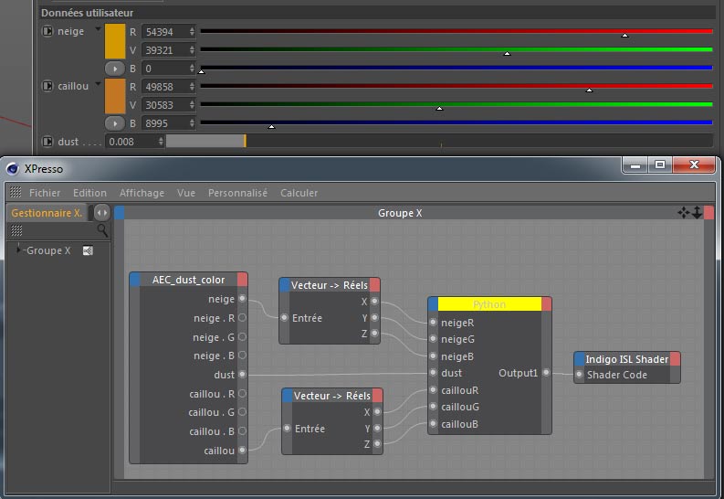

I try to input some colors, but it fail....Ilay wrote:Helloarc en ciel wrote:Hello,
it would be nice to have entries for parameters in the ISL code editor.
Try such solution - http://www.indigorenderer.com/forum/vie ... 10&t=13267
import c4d
#Welcome to the world of Python
def main():
global CodeISL
code ="""
def Zangle() real:
lerp(
doti(
vec3(
fbm(cos(normalWS().x),1),
fbm(cos(normalWS().y),1),
fbm(cos(normalWS().z),1)
doti(
vec3(
noise(cos(normalWS().x)),
noise(cos(normalWS().y)),
noise(cos(normalWS().z))
,pi()
) * %f * 50
def Snow() vec3:
vec3(%f, %f, %f)
def Stone() vec3:
vec3(%f, %f, %f)
#tweak this number to adjust snow coverage,
def Zless() bool:
gte(Zangle(), 1.5)
#lower means more snow
def eval(vec3 pos) vec3 :
if(Zless(),Snow(), Stone())""" % (dust, neigeR, neigeG, neigeB, caillouR, caillouG, caillouB)
CodeISL = codeThx
