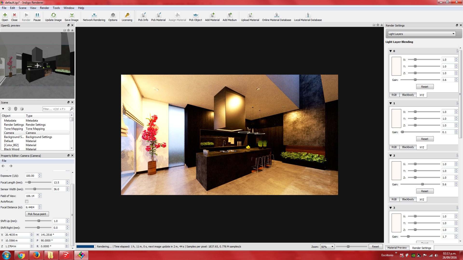

This time ( as always ¬¬ ) i am here looking out for some interior rendering advices , something that could speed up my rendering times.
It is a simple modern kitchen with 7 light layers ( includes Sun and Sky and 1 general light layer as roof spotlights ).
I have lots of doubts when is all about interiors...Like how to choose the right rendering methood, there are so many things to keep in mind... materials, modeling , light layers ,clamp contributions (use it or no to use it ? ), exit portals, cpu, gpu , (or both) light sources ...Etc, etc. I am not complaining , this is just a bit messy to me. :lol:
I tried to use Exit Portals with CPU+GPU , but they are not compatible ....is that right? .
Also tried to use BIDEIRECTIONAL MLT with CPU+GPU and did't work either, indigo change it to PATH TRACING ¬¬.
I guess Light Layers doesn't work if i enable GPU ACCELERATION ,shame cuz it was when everythings goes faster...or am i doing something wrong ?
If i enable the Foreground Alfa and CPU+GPU nothing shows up...is that normal?
These are the things that make me feel confused and so is why i am here... i attach images of my project to see if please you can give me some advices :oops:

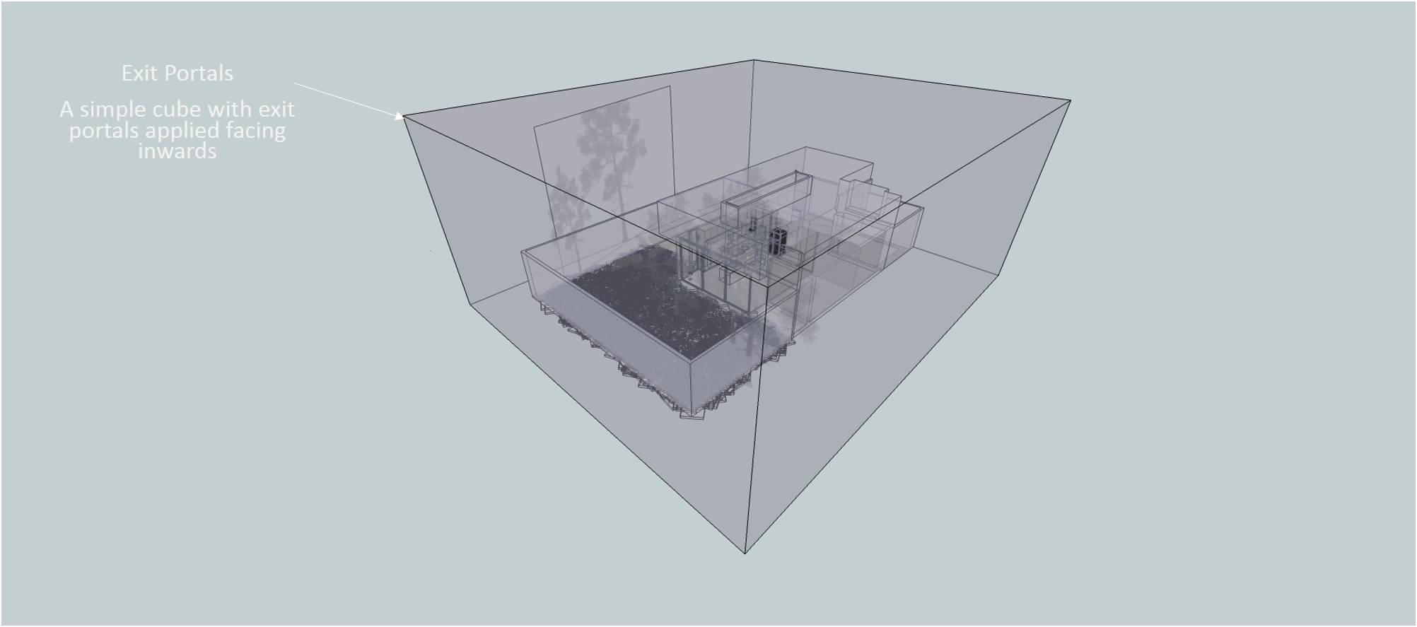

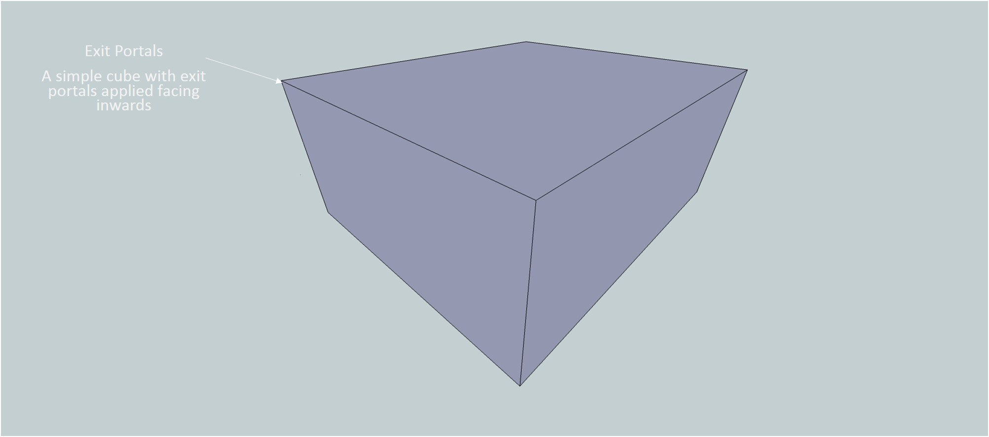

About the Exit Portals....Maybe you wont believe me , but they work very well in the "box mode". In that way Exit portals allows you to see what is behind the window ,so in my case i can see my garden :D . If i use them as they should (only in openings) i would not be able to see a thing through my window which turns into more work :roll:
I guess i'll go with BIDirect+Exitportals as you suggested and let work the light layers too.

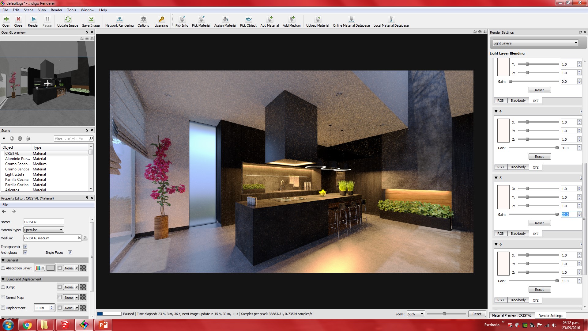

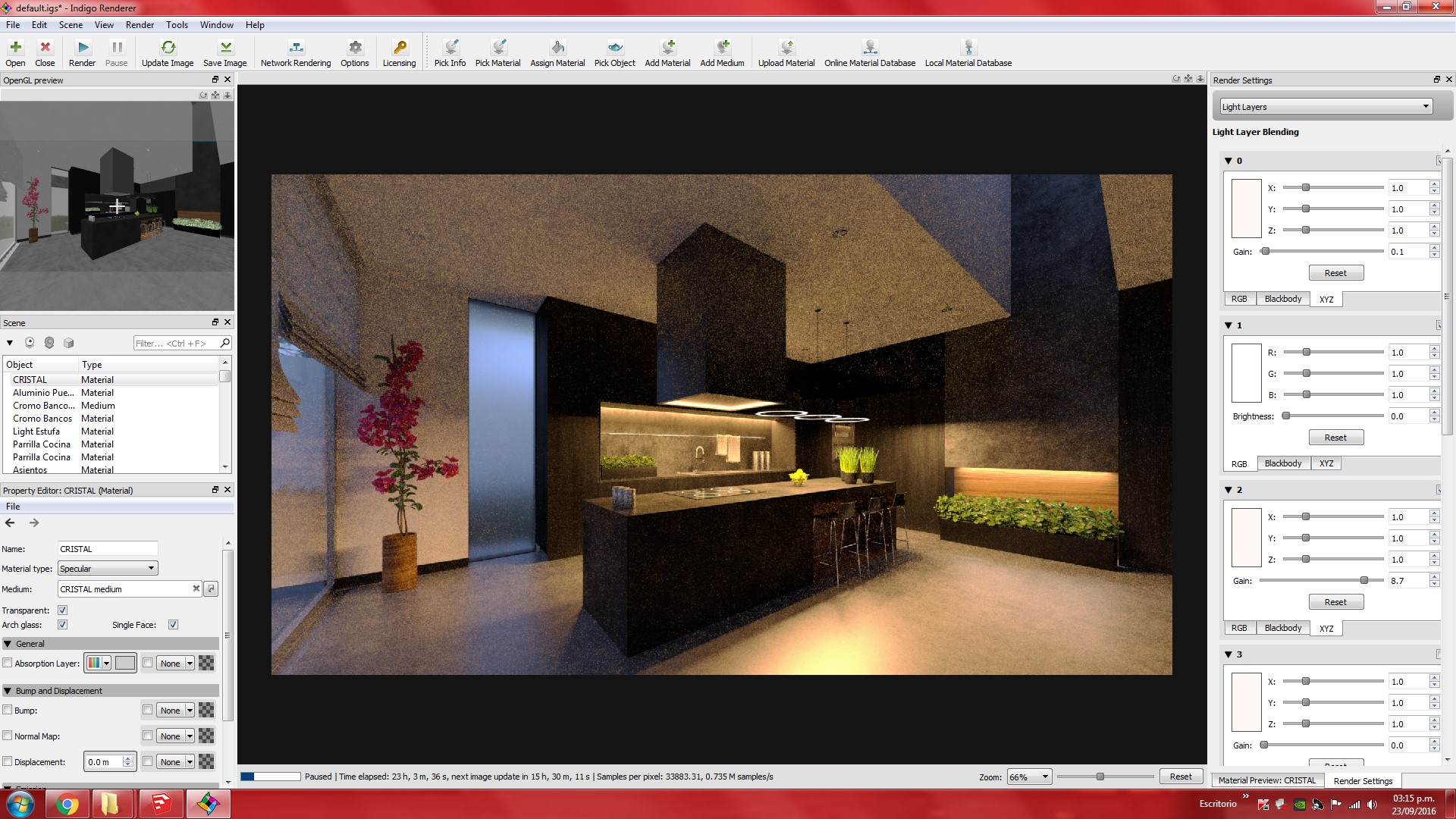

...So..i finally finish my model ( lights, materials , render and camera settings ) and send it to render....i let it " cook" for almost an entire day and....the result is below ....
For sure i am doing someting wrong and i'd like to figure it out what is the problem. Only one shot was good enough to show it because the noise :cry:
I'll attach the .pigs file if you want to take a look or give it a try . :D

When you boost a light layer by 30, that's almost bound to reveal some noise. The problem is that Indigo samples the light sources based on light intensity. If you have a low intensity light source, it will not be sampled very much. So when you boost it by 30, you get a very bright but undersampled light source, since light layers are just a post pro effect.

Ok, but then,what is the right way of setting up a night interior with artificial lights? I mean, the escene is perfectly modeled, as it should in real life, that is one of the basics of Indigo, right? Phisically accurate. I have emitter lights behind the glass of the ovens and in the same planes of the glass in the roof lamps. Is that a chance of getting such a noisy night shots? If that is not an issue.. Then what is wrong? for Sure i am missing something :cry:
Re: Modern Kitchen
Post by Oscar J » Mon Sep 26, 2016 8:56 pm
You didn't quite understand apparently. :) The outside lighting gets all the CPU priority right now - you need to reduce the HDR intensity and increase that of your emitters.

I guess i finally understand what you say,Oscar J. 8) . As you mentioned before , my light layer settings was too low . I am gonna make a test with higher settings to see how it goes. Hope it helps to solve this :wink:

Yeah, the key is not using too extreme settings in your light layers. If you want a cleaner night shot, you should probably re-render with much lower emitting intensity for the outside lighting, instead of just changing the light layers.
