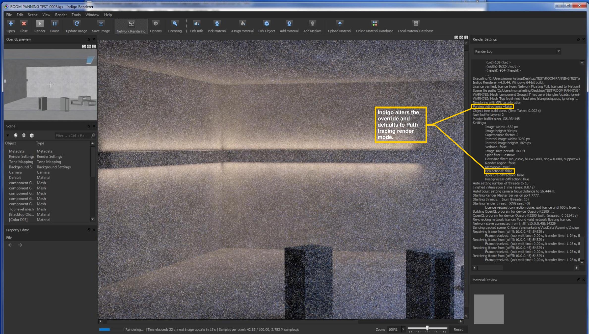

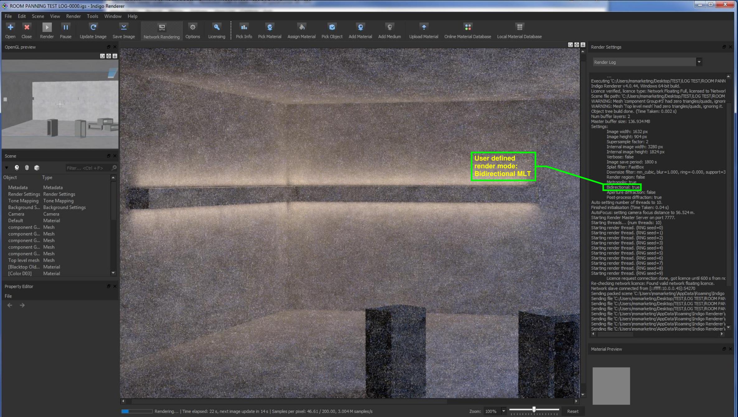

I re-rendered all my scenes and checked the logs. My finding are:
- Indigo does not apply "render mode" override settings from the render queue between each scene
sequence.
- I could not find the clamp contribution and OpenCL "true/false" status in the log. However, from the drop
in rendering speed, I believe Indigo also ignores the override settings for Clamp and OpenCL too.
Please see attached images.
Your feedback is appreciated
Thank you once again.
