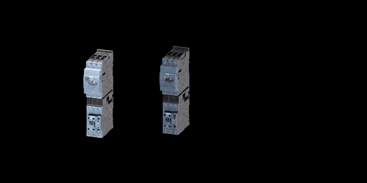

It seems that 3.8 is much darker as 3.6.26
See picture, left is rendered with 3.6.26 and right is rendered with 3.8.
(camera tonemapping)
Best regards,
Philippe
Re: Indigo Renderer 3.8.0 Beta Release
Post by Zom-B » Tue Mar 18, 2014 4:58 am
Phil wrote:Hi,
Interesting,
What Exporter do you work with?
Can replace your object by a simple sphere and verify that this behavior, then upload the scene?
