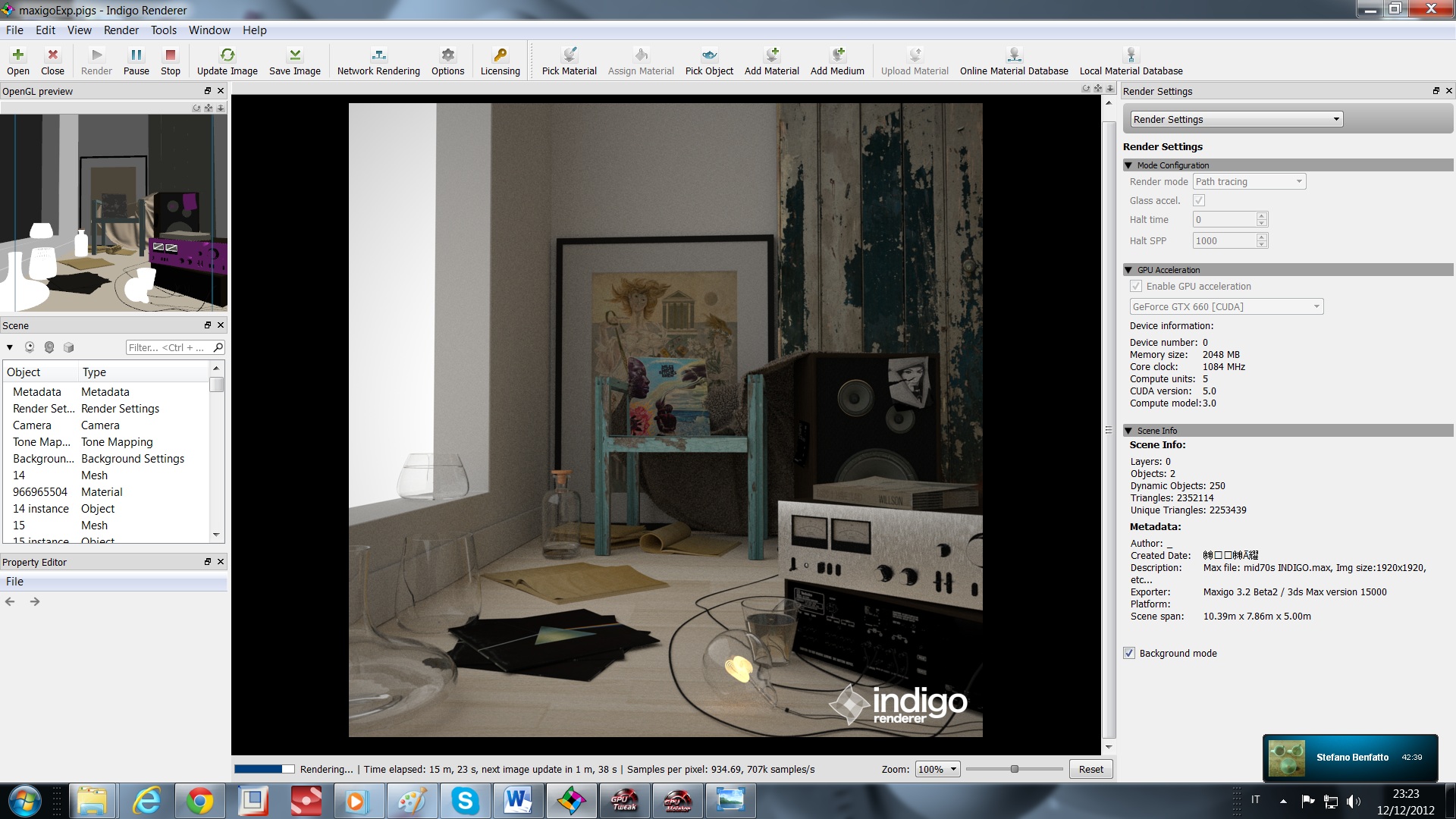

I try to do some test with different configuration.
The scene is the same for every machine.
GTX570 2,5 GB - 550 sample/s - pathtracing
GTX660 2 GB - 700 sample/s - pathtracing
GTX680 2GB - 910 sample/s - pathtracing
MacPro Dual XEON 5520 - 900 sample/s - bidirectional pathtracing
I tried to create a scene with elements of all kinds. (emitter, displacement, metal, glass)
This is just a test to understand the differences between the cards nvidia Series 5 and Series 6.
It would be interesting to do a test with an ATI card (possibly 7970 6 gb) or Tesla (maybe k20G).
There remains the question: should the gtx680 than the GTX580 (among other things now lost)?
Small note: a MacPro with Dual Xeon still behaves very well (although of course the cost is much higher than a single card) ...
I hope I have implemented a good test. I accept tips ...
S.
GTX680
GTX660
GTX570

Ok here some advice to get some more performance out of GPU rendering:
- Set the splat filter to fastbox
- manually set the threads for Indigo to CPU Core count with HT +1
Also GPUs starts flexing muscles in exterior scenes or Studio setups where rays can be killed quickly by bouncing off into space instead of going through a high ray depth in a closed room.
In the end the problem is always to get good balance between CPU and GPU power so noone of both starts to idle...
