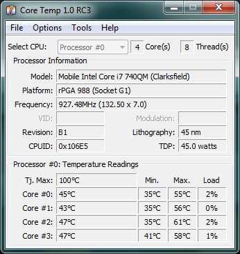

Yeah attached the core temp reading when it is running without indigo. It is a hp elitebook 8540p
http://h10010.www1.hp.com/wwpc/ca/en/sm ... html?dnr=1
Yeah warm air is blowing out so I guess the fan is working?? On the outside it looks pretty free of dust though I'm a bit hesitant to open it up as it looks like you got to pull the whole thing apart (bit of a newbie in that department). I'll get a air duster first to see if that does the trick.

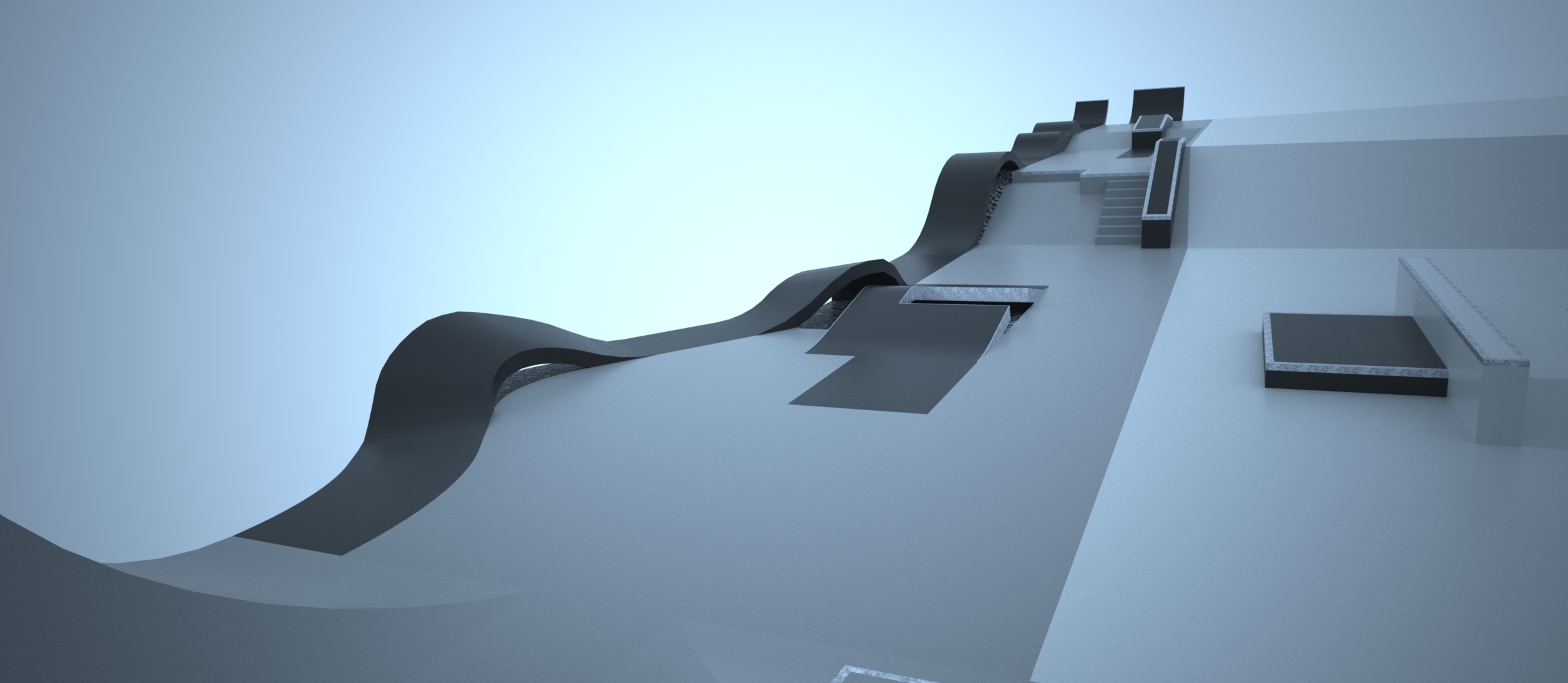

New render causing the problems...
Rerendering first model for 20 minutes now, core temps generally stable around low 80s...

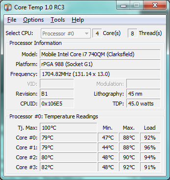

Yeah the first render that I retested kept rendering past where the 2nd one failed, though the cpu heat definitely got up there (see attached).
I thought the slave problem was also solved though when I tried to start it with this render it crashed the master as it had done previously...

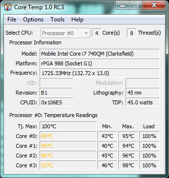

Awesome, sprayed the holes out with an air duster and now no problems, render went through the night with temperatures around what is shown below...
Cheers for the help, will keep on top of this periodically...
