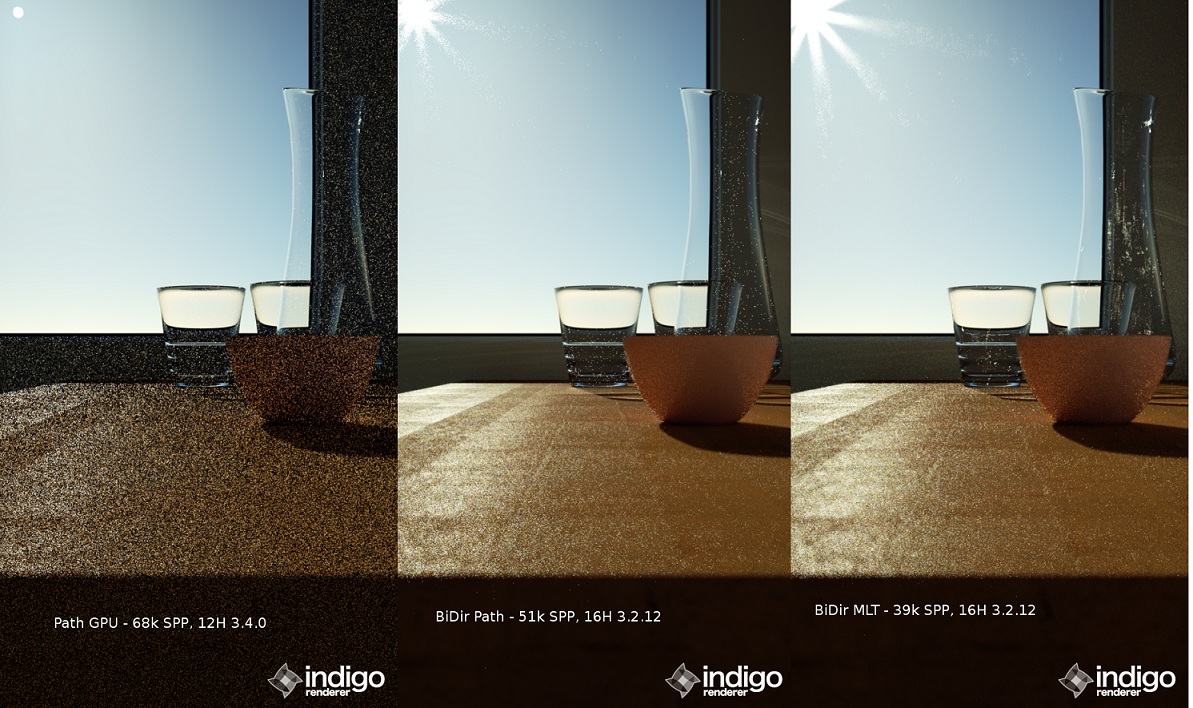

PigsOnTheWings wrote:First render with Indigo, testing how long Path (gpu) takes to clear up. This is @13h and 29k samples.
Hi PigsOnTheWings, and welcome !
You have been using an IES light profile is it ? Is this using Indigo 3.4.0 ?

And with bi-directional path tracing, not GPU single-directional :)

Post by PigsOnTheWings » Mon May 28, 2012 10:27 am
Thank you :)
I've been using IES lights, but I had to severely limit the light layer (seems all my IES overpower the scene). Camera setting would be a good idea, figured it out some time after rendering this.
For this test I used 3.2.12 since blendigo produces an error with 3.4.0. In the mean time I've begun exporting scenes to 3.2.12, then saving them and opening them in 3.4.0.
I tested this scene with BiDir MLT, cleared up a bit faster. I've edited this scene to try out the sun and sky system. Working on it now.
EDIT: Can anyone point me in the right direction regarding how to use arroway's spec maps in indigo?

I've run a few tests, with BiDir Path, BiDir MLT and GPU. I used the tip from Headroom about the spec map, though it seems to make a strange effect. Picture says it all :)
3 Render modes, same settings. Scaled down from original pictures.

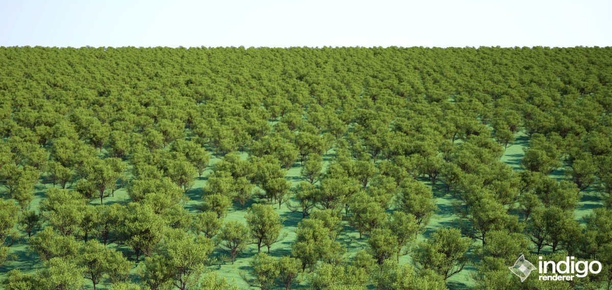

Just a litlle test:

Post by Doug Armand » Tue Jun 05, 2012 6:53 pm
Nice! tell us us more about what you used :D

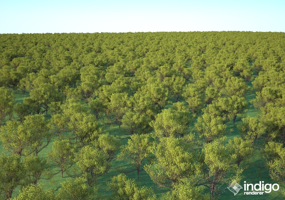

Post by Gabich » Wed Jun 06, 2012 10:21 am
There is only one tree intanced with the system particles of Blender. Each render was done in 10 minutes ( gpu render) for a total of 574 000 000 faces. It's only a test for another render (based on an old model than i rendered with Yafaray):
http://gabich.files.wordpress.com/2012/06/rerender2.png
http://gabich.files.wordpress.com/2012/06/rerender1.png

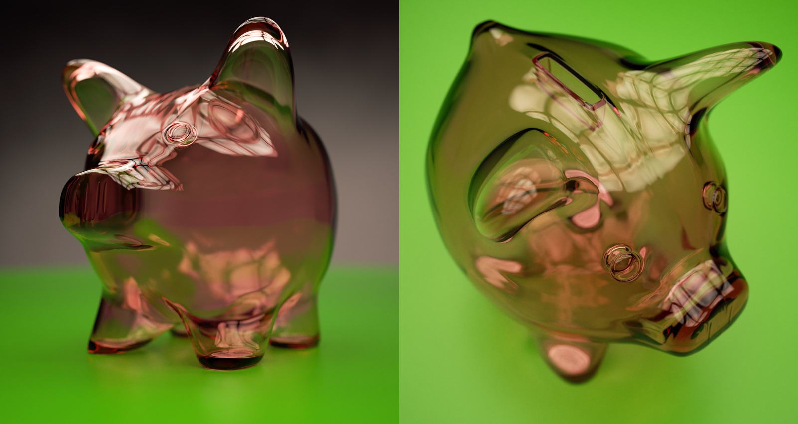

An empty piggy bank from here...
