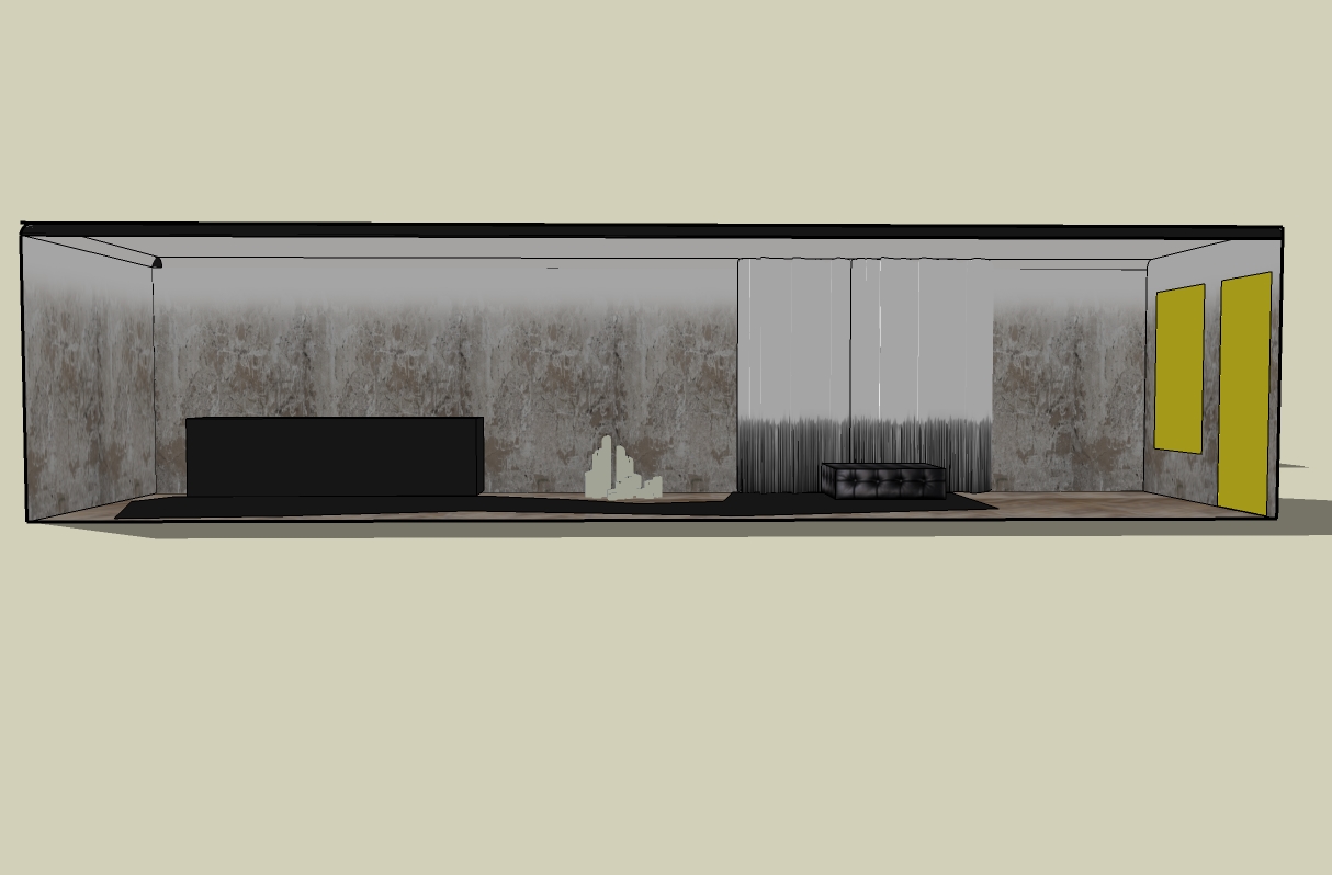

I'm having the same problem, and I cant manage to fix it. my room is all black and i'm standing looking at it and in the wall behind my camera i draw a door and window (juste planes) and made them exit portals when i render i see all black. please i would apreciat the help . thanks

Post by elDiego » Thu Jun 16, 2011 4:28 am
here is a section of my sketchup 3d model...hope you guys can help.
Re: Exit portal pitch black halp!
Post by CTZn » Thu Jun 16, 2011 4:41 am
Your camera must be inside the room ElDiego, no light will pass through the exit portals in the direction opposed to their triangles normals. If you need a view from the exterior, then you should not use exit portals at the windows and doors.

no no, my camera is inside the room, this is just an interior section so you guys see the model. i'm standing here. (see image attached)

Portals normals are pointing inward ? They'll stop the environment light otherwise.
Does the render do better without exit portals ?
Or with Reinhard (auto) tonemapping method ?
elDiego
Posts: 43
Joined: Thu Feb 03, 2011 10:22 pm
Post by elDiego » Thu Jun 16, 2011 5:06 am
yes it works once i removed that whole wall and let natural light inn.
