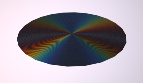

I got that yesterday evening. It is made by a shader on a single flat surface:
However, it is a big hack and the reflectance is quite low (lot of energy loss)
Basically, it is made of thin circular bump grooves for making an anisotropy reflection (classicalk pseudo-ward hack), with an overriden specular reflection color defined by a wavelength dependant shader that mimics the equation of dispersive gratings.
As the colors are made by filtering the specular color depending on angle, and not by redirecting each wavelength to a different angle, this explains the low reflectance obtained.
It is also very scale dependant : the groove bump height must be tweaked if you change the UV mapping scale, or you loose the effect.
Etienne
