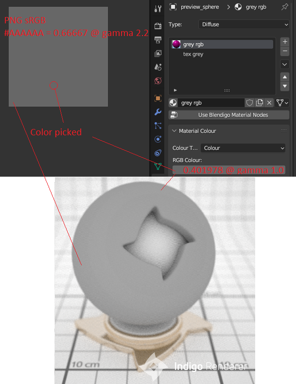

1. Created a sRGB PNG texture texture filled with #AAAAAA color. Blender translated it to 0.66667 value in gamma 2.2.
2. Color picked this texture. Colors look the same, Blender's color picker shows 0.401978
Created two materials (texture and rgb color) and render them next to each other. Seems kinda OK. I'm not sure I understand your problem.

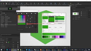

#73CF51 color after export #2B9F14
"Blender use linear space" apparently this is the reason for the color distortion.

One more thing to look out for. Blender treats hex code as a sort of sRGB standard, while in Indigo it is just a 0-255 value representation. So hex in Blender always represents gamma 2.2 corrected color, while in Indigo it is not correlated with gamma.
I see where this is going. Considering future material nodes, I think that standard color sockets should remain in linear space as is color picker and the rest of Blender. However, gamma node can be added, or something like 'color as sRGB' node for less savy users. What do you think?
