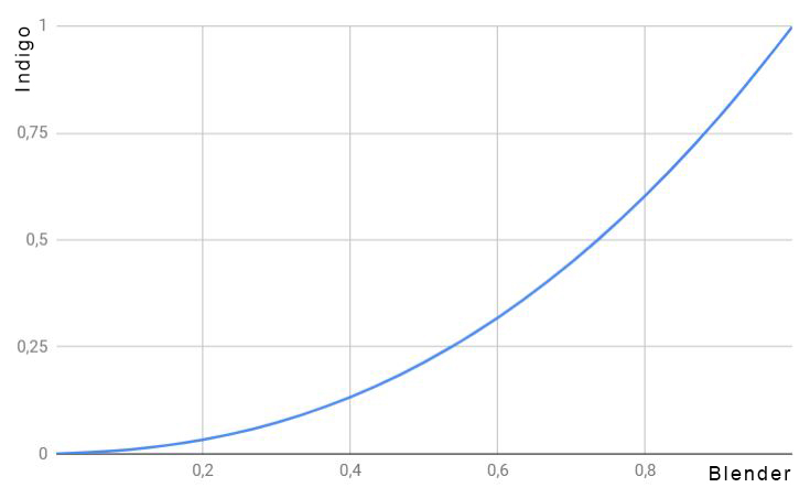

I made a scene and noted the V value (HSV) from 0-1. This is what I get:
(greyscale)

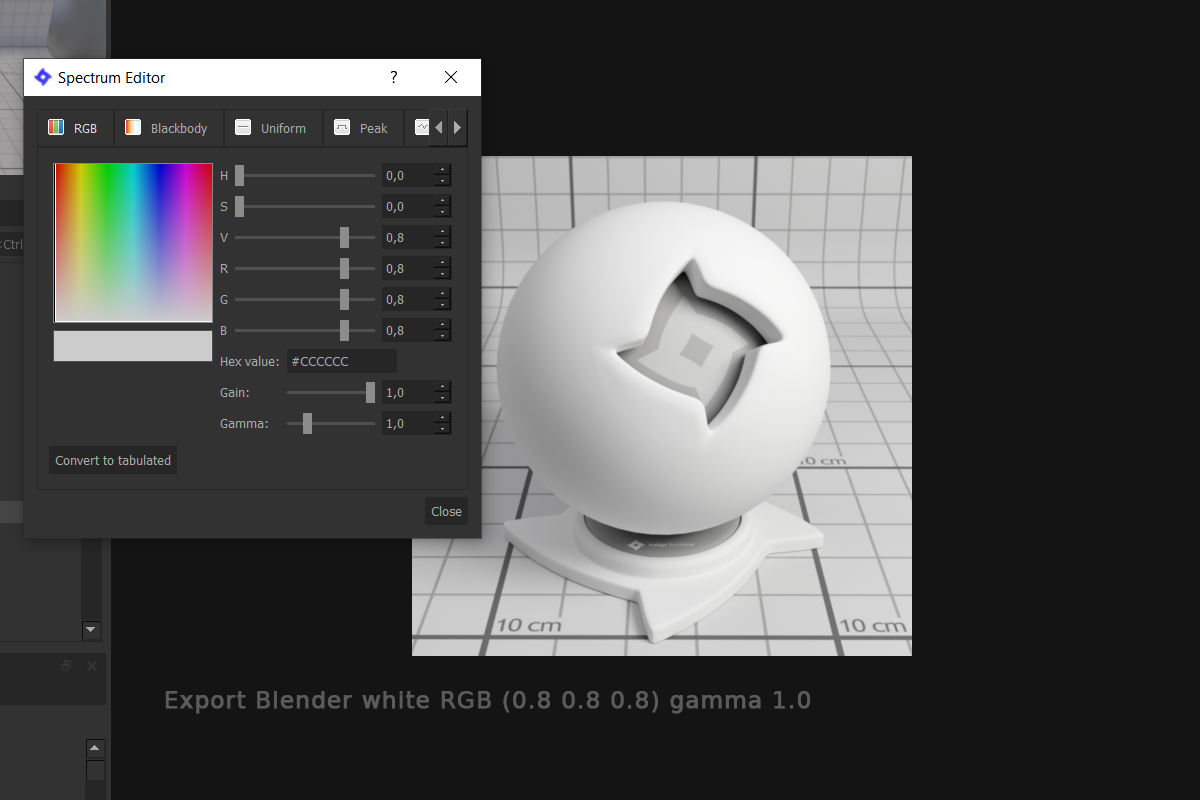

Blender > Indigo gamma 1.0
Indigo default material scene gamma 2.2
ps this applies only to a simple Diffuse color, when exporting textures, there are gamma settings :!:

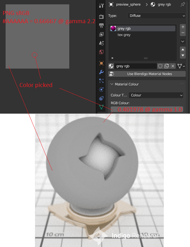

1. Created a sRGB PNG texture texture filled with #AAAAAA color. Blender translated it to 0.66667 value in gamma 2.2.
2. Color picked this texture. Colors look the same, Blender's color picker shows 0.401978
Created two materials (texture and rgb color) and render them next to each other. Seems kinda OK. I'm not sure I understand your problem.

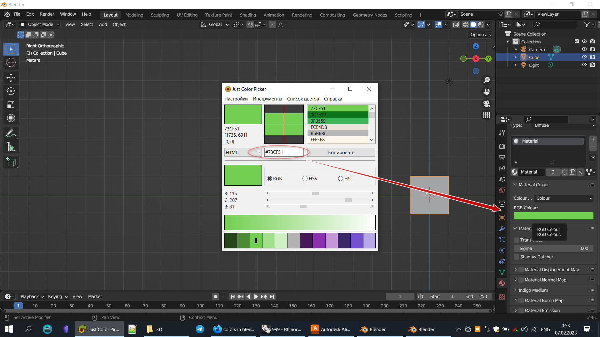

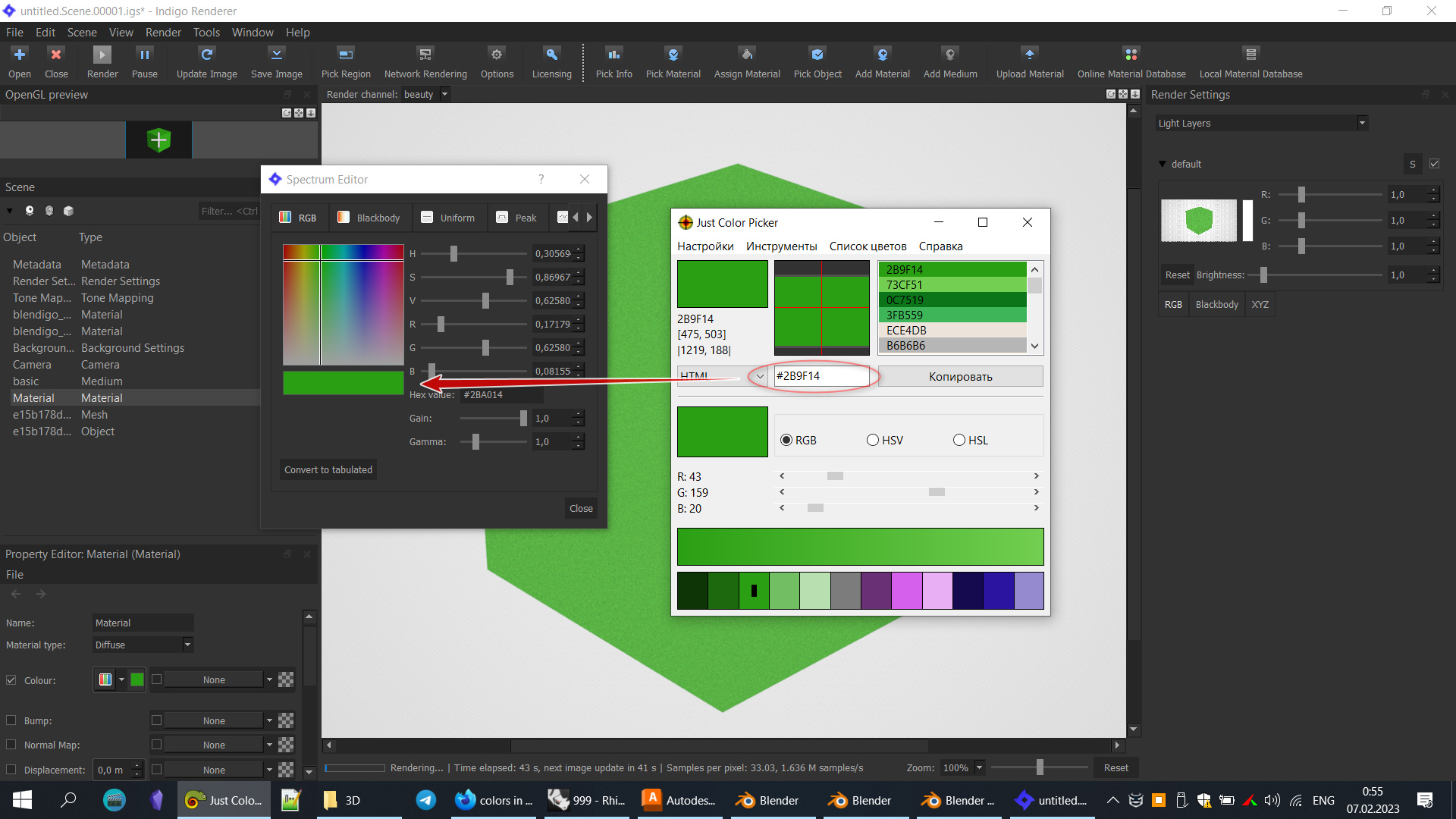

#73CF51 color after export #2B9F14
"Blender use linear space" apparently this is the reason for the color distortion.
