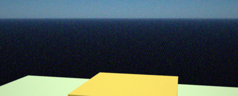

amazing ... i understand the atmosphere feature
thanks to yonosoy! i have tested it to setup manually in blendigo without any external editing (textfiles...) and it looks good to me:
'Automatic atmosphere setup' in blendigo is possible. Have to think about the implementation...

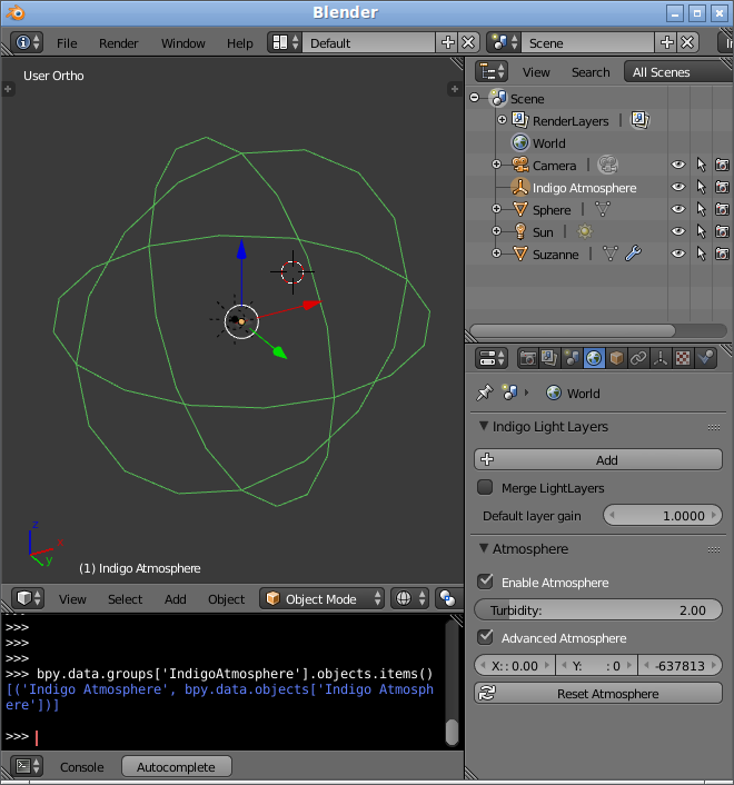

Atmosphere is now out of medium panel and moved to world panel as 'atmosphere feature':zurkdahool wrote: 'Automatic atmosphere setup' in blendigo is possible. Have to think about the implementation...
How it works:
Enable atmosphere will add empty sphere (Indigo Atmosphere). This is just for imagination... When exporting the scene to indigo the sphere, specular material and atmosphere medium will added automatically. After export the sphere will be deletet (not implemented yet as you can see in the screenshot

Very nice! Like the option of being able to relocate it in the Advanced tab.
Is this in the git repo? Should I be keeping up to date with that?
