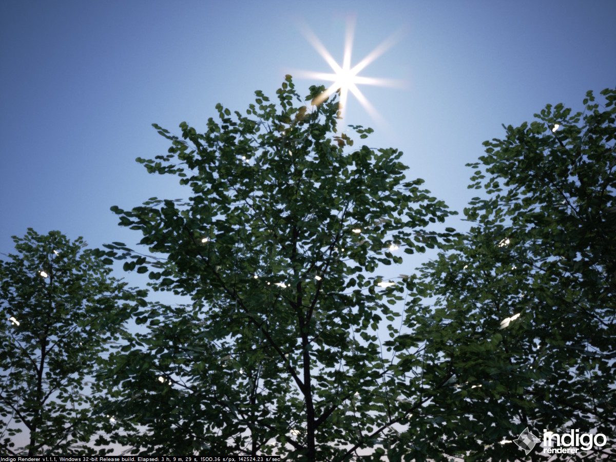

I noticed in another thread that you can get the XFrog Sweet Birch model for free from TurboSquid. So I decided I would do some tree rendering.
In the process of making the render I've found several bugs/issues :)
I've also changed the way null materials work in order to make alpha mapping converge faster.
The leaf material is a diffuse transmitter / phong blend (then all blended with null for the alpha mapping)
I'll make a short tutorial for setting up this material as I think it's a core material technique that all Indigo users should understand :)

Wow, this would look even better with volumetrics :)
Gotta see that tutorial, maybe this would work for billboarded grass renders.

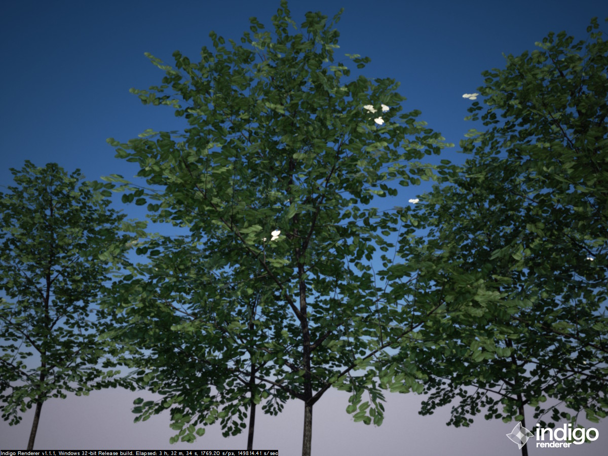

another one..
Post by suvakas » Sun May 04, 2008 7:30 pm
Time stamp? A new feature ? =P
Posts: 6243
Post by OnoSendai » Sun May 04, 2008 7:34 pm
yup :)
