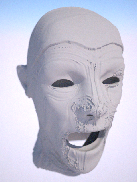

Thanks a lot both ! I havent showed these much before, and they have a few years now, the "camel man" is the most recent (~2 years). You'll understand me better when I say i'm a lazy guy :) And anyway I'm not experienced enough with ZB itself to call myself a ZB user, "Camel Head" is just a successfull sculpt amongst many tries... For instance I know ZB has 3 ways to export UVs on meshes but I couldn't say wich suits Indigo better...
Aleksandera, I swear your scene would be rendering by now here, if it wasn't a blend :? Thought in the post following yours, zsouthboy is pointing the same solution than I did; definitly you should give that <c> a try !

Post by CTZn » Sat Jun 28, 2008 12:13 am
lol wait :D
That's what I got from Maya internal with displacement as color. For this I left alpha gain (<b>) to default 1 and set alpha offset (<c>) to -0.650. This is not guaranteed conform to the original (in ZB) since I'm guessing the values here.

Post by CTZn » Sat Jun 28, 2008 1:35 am
Aleksandera: I can imagine your face when you first saw the above pic :lol: sorry for that, as I told that was guesswork :mrgreen:

Post by BbB » Sat Jun 28, 2008 1:37 am
This seems to create additional geometry to fill the gap between the seams. It's not quite the same as making the seams disappear though...
Post by CTZn » Sat Jun 28, 2008 1:47 am
That's how maya internal displacement manages this too... Indeed it is not enough to set c=b/2, you also need to know the right value for b and I believe zb provides this at some point. That's because I don't know this value that you can see some glitches i believe, for me it's working 100%. (edit: erm that's not correct finally)
edit added packed scene above
edit 2: Actually I'm investigating more on this. To tell the truth I would love to investigate a proper doc, explaining what <c> should be set to, because it is necessary for compatibility with most 3d apps featuring displacement, and those who don't need it can leave it alone anyway.

Post by BbB » Sat Jun 28, 2008 3:34 am
Isn't the b value relative to the object's scale in your exporting 3D app? In this case, unless you can export straight from ZBrush to Indigo, setting b at the right value can only be a matter of trial and error. AND, it will be different for every new scene/object/sculpt...
What we would need then would be a standard workflow for ZBrush-to-(your 3D app of choice)-to-Indigo that also includes scale.
I've no idea what I'm talking about so please correct if I'm wrong...

Post by CTZn » Sat Jun 28, 2008 12:48 pm
By the way I didn't answer to you BbB; yes b is expressed in Indigo units, it's the same for bump unless the later is kinda fake would say Ono. I guess ZB has an internal unit system too, or it wouldn't provide alpha depth; it is directly usable in Maya and Maya uses cm, so divide the value /100 from ZB to Indigo. My guess.
