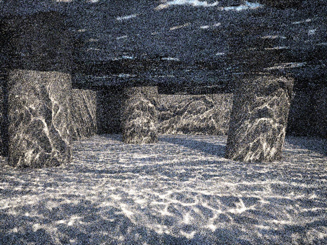

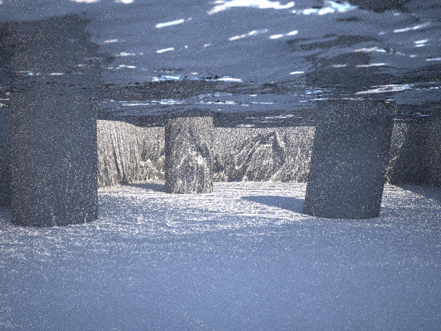

This scene I'm did to compare to Fry. I did 2 renders, one with a ground plane (same for Fry) and one without a ground plane outside of the view, or pool in this case. Huge difference in render times. And this brings Indigo's render time inline with Fry. I suspect Fry removes all geometry not in view from the calculations automaticly!
Because at the same render time, Indigo and Fry are neck to neck sample count wise, with 20million samples a piece at the 47 minute mark.
Removing the big ground plane outside of the view brought about massive differences in the render times to results ratio.... :shock:
The sample rate is exactly the same as well, and I used Bidirectional MLT
2nd one is still dark from the supersampling, but man the caustics are all there very quickly! The first one was developing caustics dot by dot :?
maybe Indigo's engine needs some sorting in this area ;)
No ground plane....and only 6mins render time...
with ground plane... after 4+ hours!!!!

actually the pic is still dark after more rendering, and with different overall colours...
so even with the same tone mapping settings the pic is rendering differently without the ground plane, not just speed wise!
This is expected with bidirectional path tracing.
When you have a large plane, rays are cast from the sky to all positions on the plane. Therefore the chance of the ray hitting the surface of the pool, and then making a nice caustic path, is much less than if there is not a big plane under the pool.
So, when using bidir path tracing / bidir mlt, try and make the size of the scene not much bigger than the 'interesting' portion of the scene - i.e. the volume you will be looking at directly.

CoolColJ wrote:actually the pic is still dark after more rendering, and with different overall colours...
If it converges to a different result, it's a bug.
Can you post the scene, or email it to me?
Just the one version as an .igs should do, I can comment in/out the ground plane.
