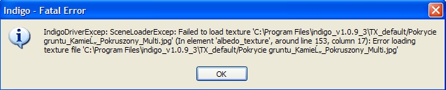

It probably problem with polish letters in names of textures. I found that I can change names of textures from polish to polish without special letters, but it is very stupid and takes a lot of time. Do you know how to resolve this problem?

I noticed some problem in SkIndigo. I use polish version of Sketchup. When I tried to render my project I always get message: (in attachment).

..I'm afraid you cannot use special letters using Indigo and SkIndigo.
The only thing I know you can do is changing the problematic characters with some standard ones, with no accents or special features..
Re: Foreign letters in the name of textures
Yes - sorry about that, ascii characters only.
