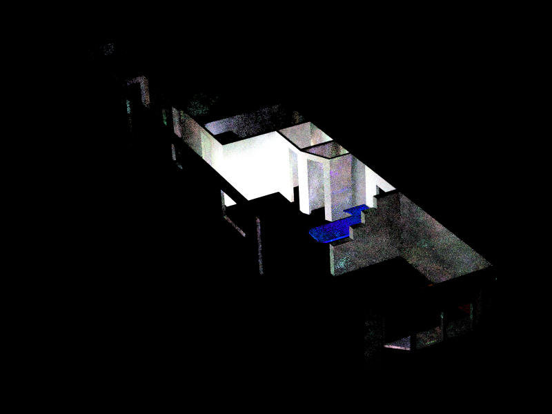

xrok1
Posts: 287
Post by xrok1 » Thu Aug 09, 2007 4:43 pm
:lol: great!
i don't get why you think you have normal problems. i can see everything in my scene when i render? looks good.
by the way have you considered using the textures instead of the physical materials? or are you, because i thought i saw in one of your posts that you use materials not textures?
p.s surfaces still don't show up have you noticed this? there is a floor in this model but its a surface.

xrok1
Posts: 287
Post by xrok1 » Fri Aug 10, 2007 11:32 am
SW06 also uses all these features bump, env, masks...
xrok1
Posts: 287
Post by xrok1 » Fri Aug 10, 2007 11:47 am
here is a photoworks render, not bad but a pain. SW06
