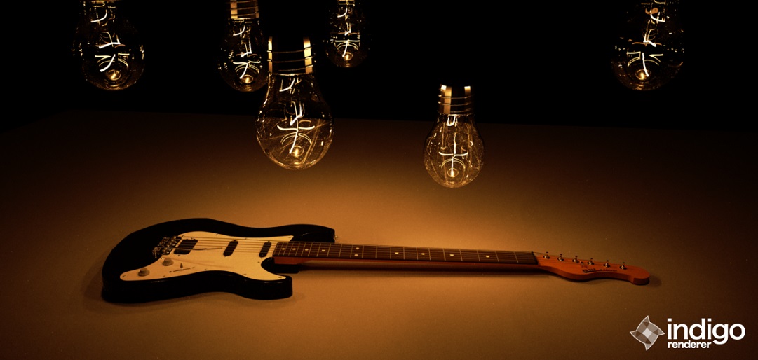

o_0 The new glass acceleration is freaking awesome! I had some lightbulbs and they were comming out black. I turned on glass acceleration and they instantly rendered clearer when i restarted the render.
Re: Indigo Renderer 3.8.0 Beta Release
Post by Zom-B » Sat Mar 15, 2014 10:29 pm
neo0. wrote:I had some lightbulbs and they were comming out black...
I hope you understand that black lightbulbs are 99,9% chance of bad modeling, rather then Indigo doing something wrong...
Post by neo0. » Mon Mar 17, 2014 5:37 am
This is what I assumed but the lightbulbs have thickness and when i turned on glass acceleration, they become see through like they should almost instantly like I said. :)
Post by Zom-B » Mon Mar 17, 2014 5:48 am
Double check the normals of the bulb. the glass polys on the outside need to point away from the center of the bulb, the normals of the inner sphere of the glass need to point into the center!
The humbucker of the guitar looks quite far in the back for my eyes, but maybe I'm wrong ;)

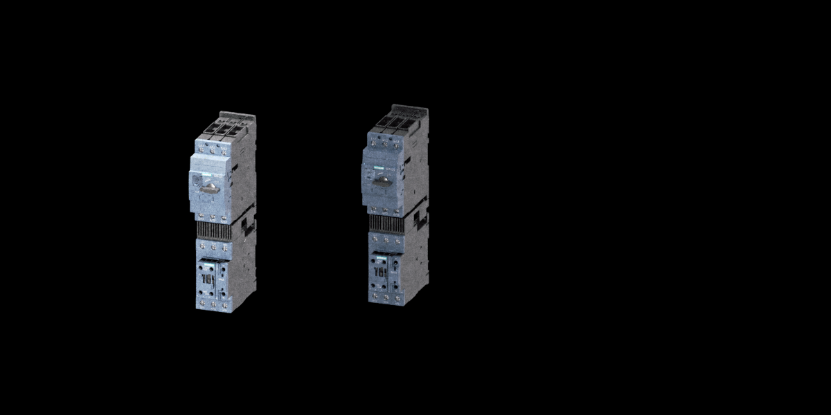

It seems that 3.8 is much darker as 3.6.26
See picture, left is rendered with 3.6.26 and right is rendered with 3.8.
(camera tonemapping)
Best regards,
Philippe
Post by Zom-B » Tue Mar 18, 2014 4:58 am
Phil wrote:Hi,
Interesting,
What Exporter do you work with?
Can replace your object by a simple sphere and verify that this behavior, then upload the scene?
