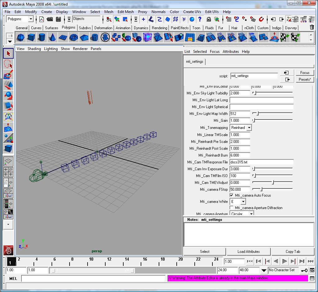

here's the defaults, with 1cm cubes:

Post by Big Fan » Sun Jan 27, 2008 11:21 am
well I am not sure what I am looking at there cos I dont use maya - but it looks from the 3d window like your native
distance from the camera to the origin is 10 cm? ...macro phototgraphy... even at 10x this its quite um close..
but ok you have an FStop of 50!? (odd size)...and it gives this.. :?..strange..
but auto focus (which actually focuses indigo on the closest mesh point in the scene ) is set on...
to me it all looks weird.. :? I dont really know that what you are doing and getting out of this is sensible
how do your materials, lighting and nudge work out correctly for a scene if you are always 10x out with your scale?
to my old eyes it looks like its all out of focus and the in focus bit is away in the distance somewhere..

Post by dougal2 » Sun Jan 27, 2008 11:35 am
Actually, i agree it's a bit of a duff test, scenes generally tend to be larger than this and the camera doesn't usually focus this close.
Things usually work out fine, if I keep in mind that each grid square is 10cm rather than 1cm(Maya default) or 1m(pretty much everything else).
