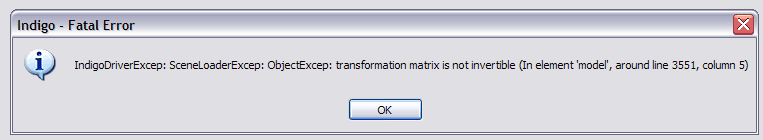

Post by pixie » Wed Jun 04, 2008 4:49 am
This is a recent error I have. Does anyone knows the reason why?
Post by fused » Wed Jun 04, 2008 5:04 am
sry thats due to cindigo. the matrix i generate is bad at times.
will be fixed in the next release. a simplified test scene would help, tho.
