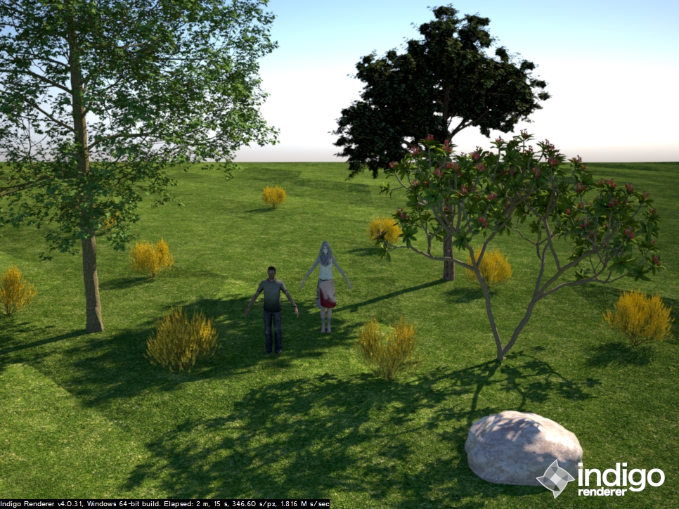

A Laubwerk generated scene with a couple of characters and 5Mil poly is working, also with 50Mil poly is working (with a 15min scene building time) with Reinhard tone mapping, using the camera did remain black.

Curious. Have you tried the other tonemappers and cranking their values way up?davide445 wrote:A Laubwerk generated scene with a couple of characters and 5Mil poly is working, also with 50Mil poly is working (with a 15min scene building time) with Reinhard tone mapping, using the camera did remain black.

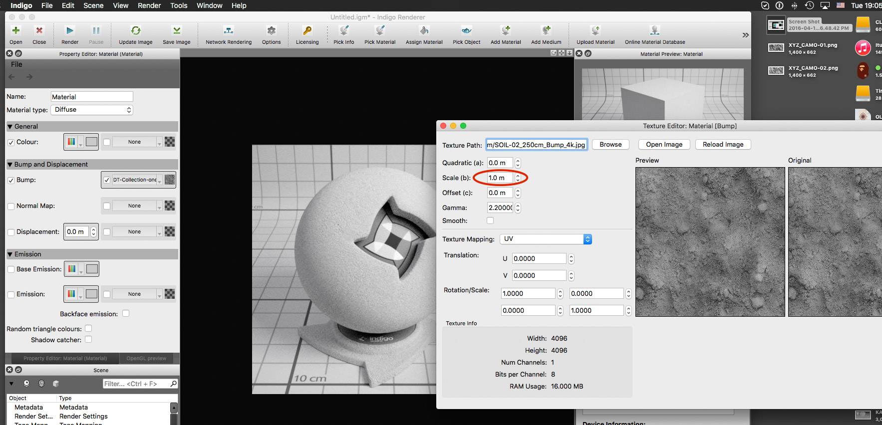

[BUG 4.31 OSX]
Bump Maps not working at all.
Tried in every mode CPU & GPU rendering.
(UPDATE) They work, just Scale (b) is set to a super tiny size as default so it does not recognize the texture. I set it to 1m textures magically appear & work. Maybe raise them from start up?

- Oscar J
- Posts: 2204
- 3D Software: Blender
I think 0.001 m is a kinda good default size for bump maps - wood, stone etc. look pretty much right with that. For scales of 1 m you should definitely consider using a displacement map. :)

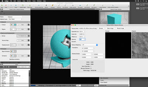

- Originalplan®
- Posts: 757
- 3D Software: Cinema 4D
Yep.But sometimes it seems not working at all untill i bimp it up to 1m and then back to 0.001.Oscar J wrote:I think 0.001 m is a kinda good default size for bump maps - wood, stone etc. look pretty much right with that. For scales of 1 m you should definitely consider using a displacement map. :)
Might be a bug in kernel rebuilds; when you see weird behaviour like this, you can confirm it by switching to normal CPU mode (non-OpenCL) and seeing if it works properly then. If that fixes it then please let us know

- Originalplan®
- Posts: 757
I will. Didn't had much time yesterday to test it.lycium wrote:Might be a bug in kernel rebuilds; when you see weird behaviour like this, you can confirm it by switching to normal CPU mode (non-OpenCL) and seeing if it works properly then. If that fixes it then please let us know :)
Just wanted to create a material...and it seemed to not work at all untill i bumped it up to 1m.
I didn't switch CPU-GPU mode....but i will try it nextime i get this and will let you know.
