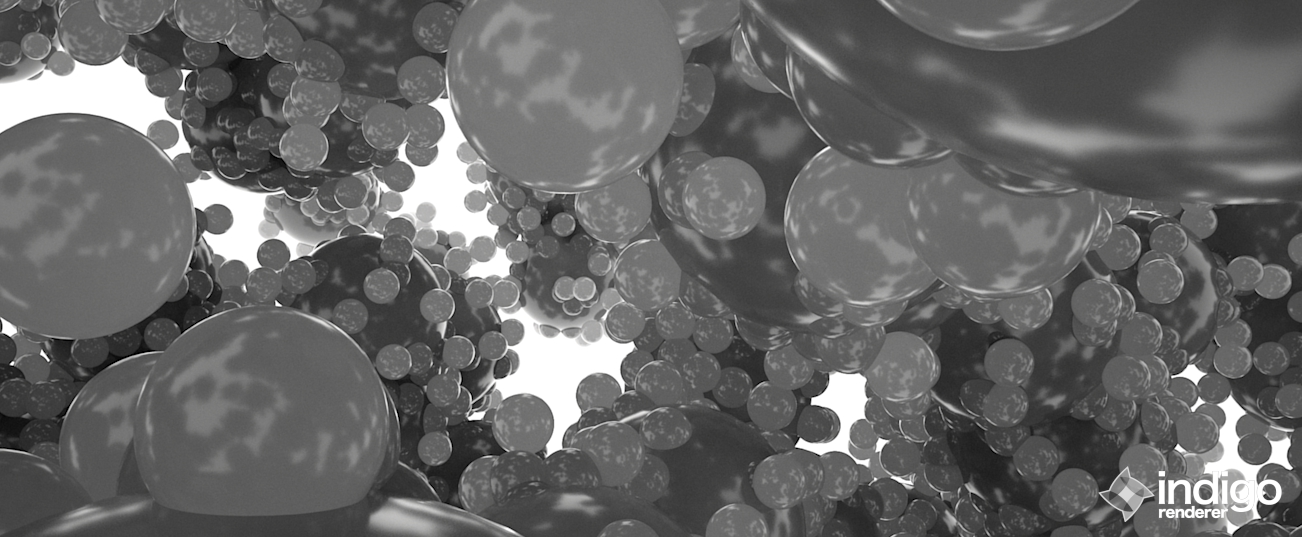

yonosoy
Posts: 3439
Post by yonosoy » Tue Apr 19, 2016 10:21 am
I´m expecting a miracle speed with clouds via GPU. This benchmark scene is an evidence.
As crazy as always. 50001 icosaedro spheres with the same Fast SSS material (preset).
about 20 min of render
Benchmark for the scene:
Dual Xeon E-5 2620v3: 0.070 sps
GTX 980: 1.290 sps
Path tracing both. Wow, no words.
PD: very far from an optimised scene for test because there are spheres inside spheres,
again a complex thing.
fast_exportation.pigs
(1.97 MiB) Downloaded 324 times
