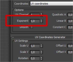

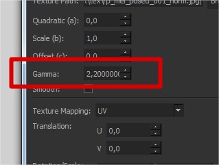

Re: IndigoMax 0.6.4
Here I think the value is not linked to the value attributed in the igs created.
Then I think that the default value should be 1.
The texture preview in Indigo renderer seem to show something not corresponding to the gamma atributed (especially when you work on Displacement map or Normal map)
Albedo seems to be oversaturated.
Could you check the process under the 3ds Max exporter; then the math used for this gamma value under Indigo renderer to assure that a Normal map or a displacement map use really a Gamma of 1 instead of 2,2?

Re: IndigoMax 0.6.4
I think Indigo ignores gamma input for normal maps, but you're probably right about displacement.
