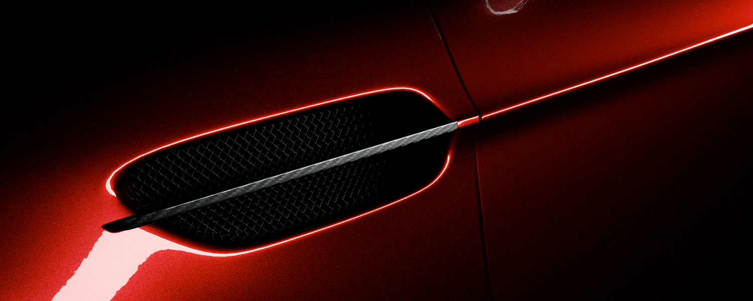

Strange - I successfully used fbm bump for the coating of my carpaint material: http://www.indigorenderer.com/forum/dow ... &mode=view
I used Indigo 3.8.25 for that.

PosOS() works fine and is the one you use for the orange peel of the carpaint (what a beautiful material).

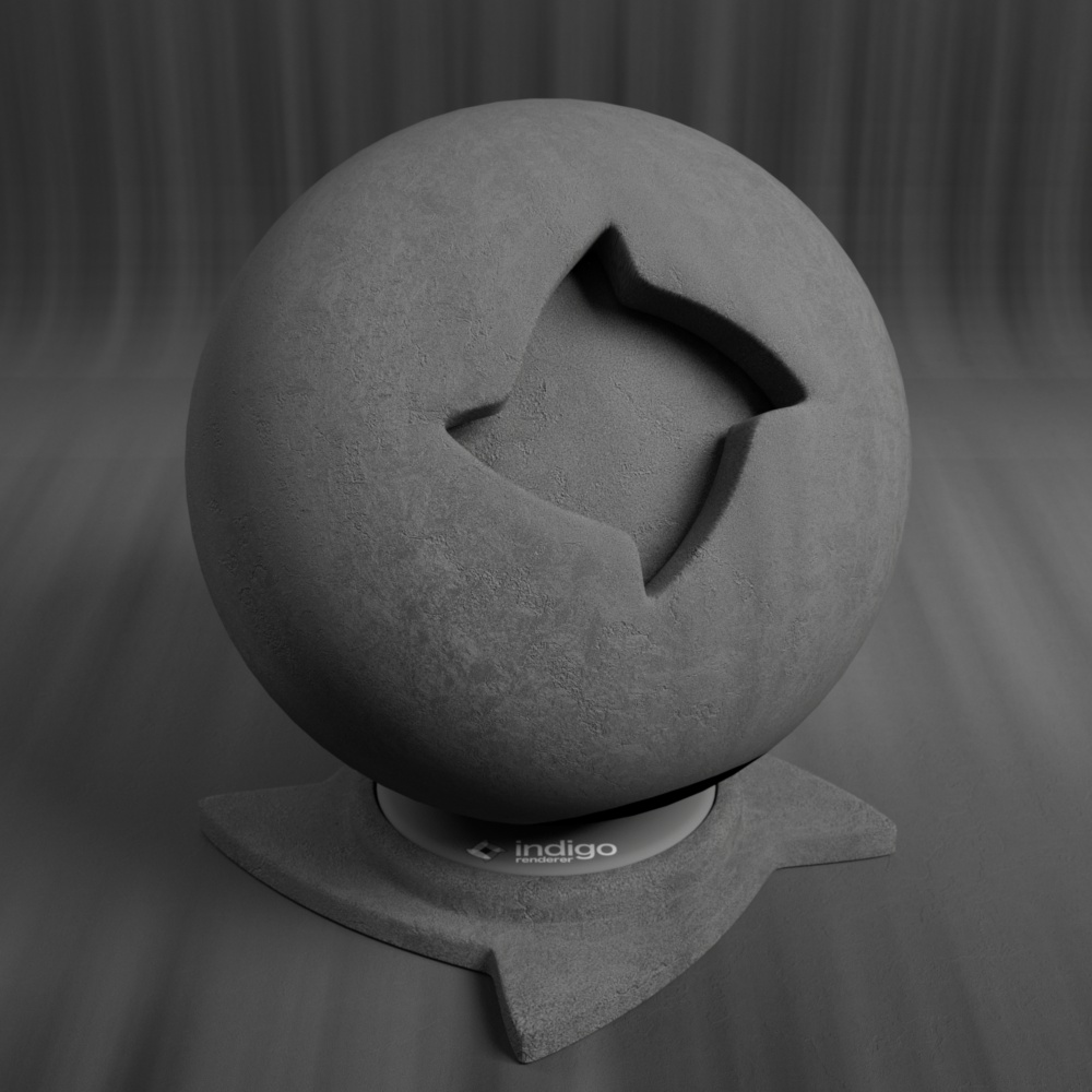

I experienced a partially black albedo shader just yesterday, the bottom of the render sphere was showing black (it's not uncommon when developing shaders). I'll take notice of the circumstances next time and report.
edit: actually it's illustrated here. Probably happens when very high pos/tex frequencies are involved.
