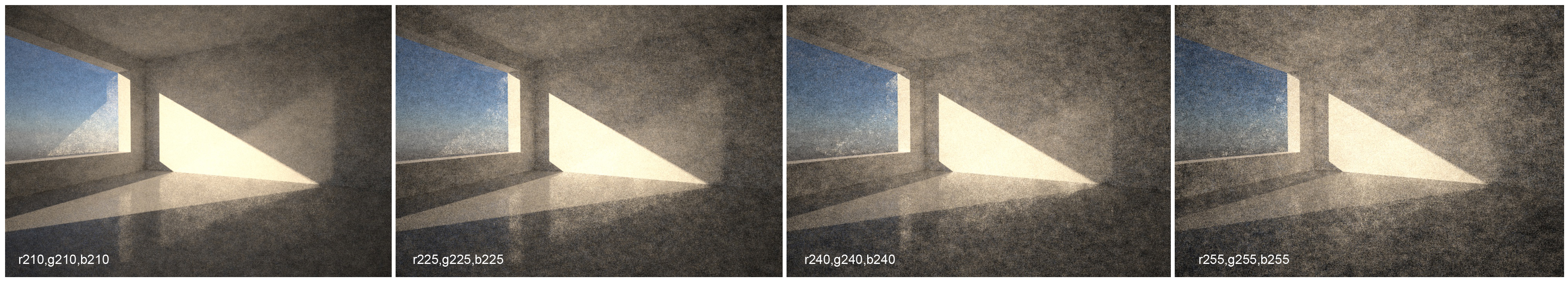

WHITE RGB VALUES
So as a really simple illustration of the effect of upping RGB values on white surfaces, here are some figures and an image. A very simple box room with a simple 'phong' floor and a 'thin glass' window, lit only by the default Sketchup sun. Render resolution was 1000x700 and all I changed in each shot was the RGB value of the white walls. Render time in all cases was exactly 1 minute. Results are in samples per pixel (SPP) and the speed value K
r255, g255, b255 - 10.48spp @ 121k
r240, g240, b240 - 16.08spp @ 186k
r225, g225, b225 - 21.52spp @ 247k
r210, g210, b210 - 25.43spp @ 295k
The difference is fairly pronounced when you look at the figures. Pure white (255,255,255) is rendering almost 3 times slower than a more realistic value of 210,210,210. The proof is in the image - the image on the left is noticably smoother and the image much more resolved (see the reflection in the glass).
So yeah, white values of no more than say 205,205,205 to 210,210,210 give or take and you'll find much less time taken to get an acceptably smooth image.
If you're craving pure white walls in the final image then you can play with the whitepoint values in the Indigo GUI or even get on with some Postpro.

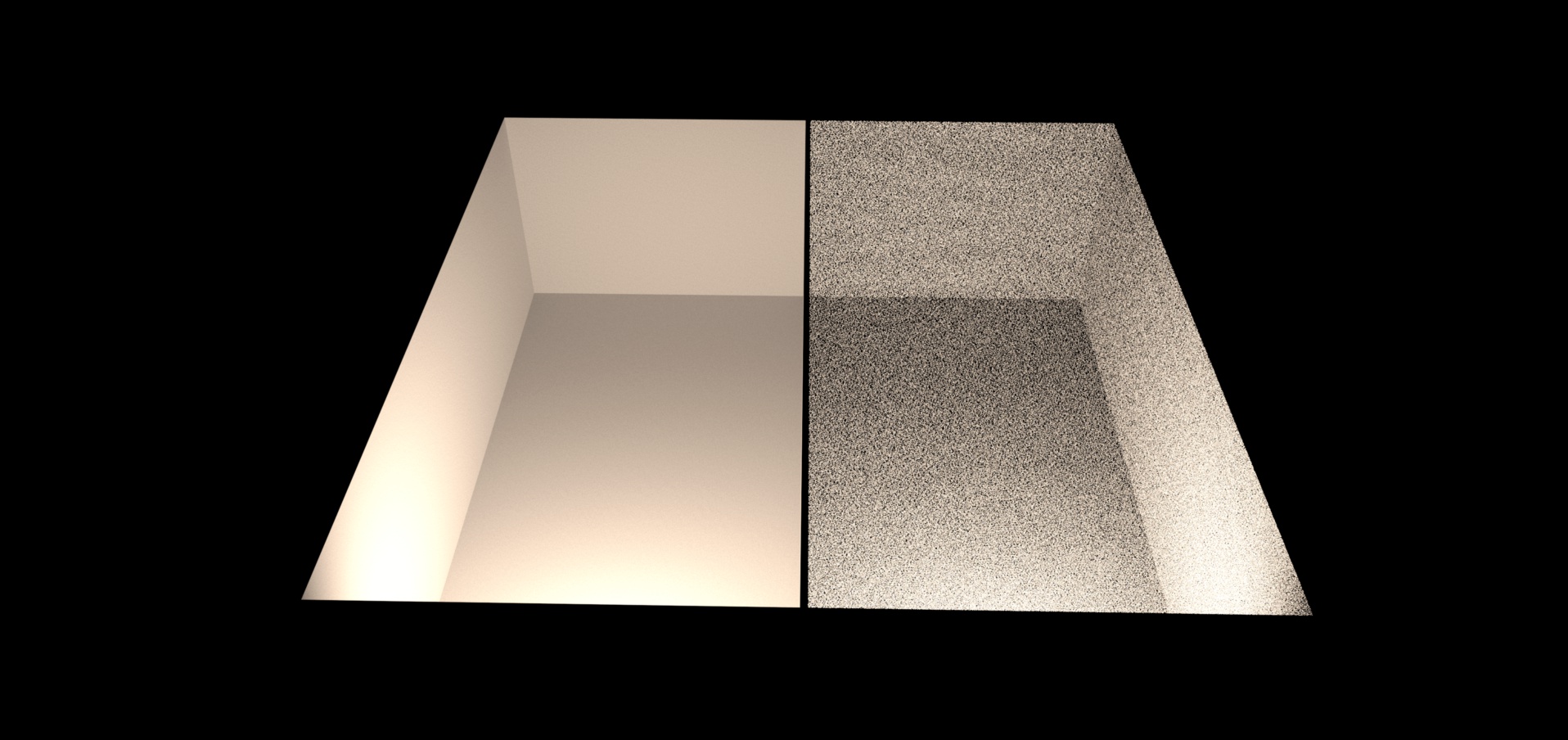

EMITTER POWER AND RESOURCE ALLOCATION
Its tempting to assume that no matter how powerful your lights, Indigo is assigning each the same amount of processing power. Not so! A simple thing, but worth noting is that Indigo assigns more processing power to more powerful lights. In real terms this means that objects lit by, say, the sun will converge and clean up far faster than objects in the same scene lit by a less powerful emitter.
The interesting/useful thing about all this is that you can use it to your advantage - massively overscaling certain lights to ensure they get the bulk of the rendertime, then scaling down in light layers (assuming you're not using RT) to something approaching normal.
As a simple illustration then:
Light 1 on the left has a lumen (lm) value of 500,000
Light 2 on the right has a lm value of 2500 so only half a % of light 1.
The render is left to run for a minute or so and then then the gain of light 1 is dropped to 0.005 (ie half % of the original 500,000) essentially resulting in the same lm value as Light 2. Its pretty clear which light has been given the rendering priority in Indigo.

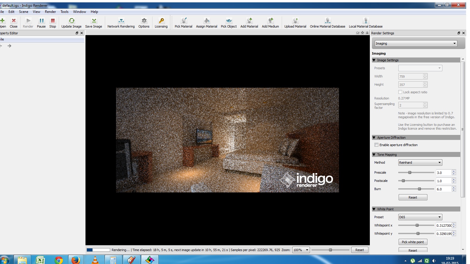

Ok so ive been rendering this for the last 8 hours and its only gotten worse. I havent added any textures as yet just so that i could get the lighting correct, but it looks like im not doing something right. how do i make this better? and how long does a typical render take to complete?
