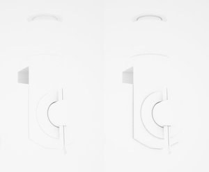

Yes, I reported a quite similar issue back in 4.0.15 to the devs, I tested the example scene I provided back in the day and can reproduce the problem:
left CPU - right GPU

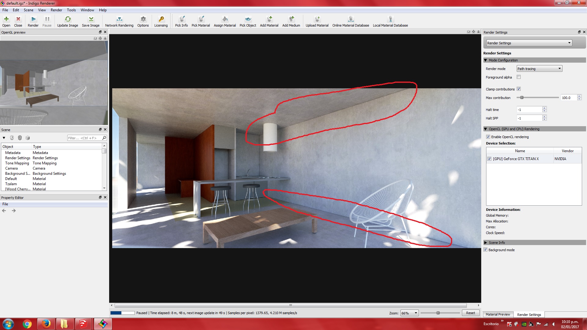

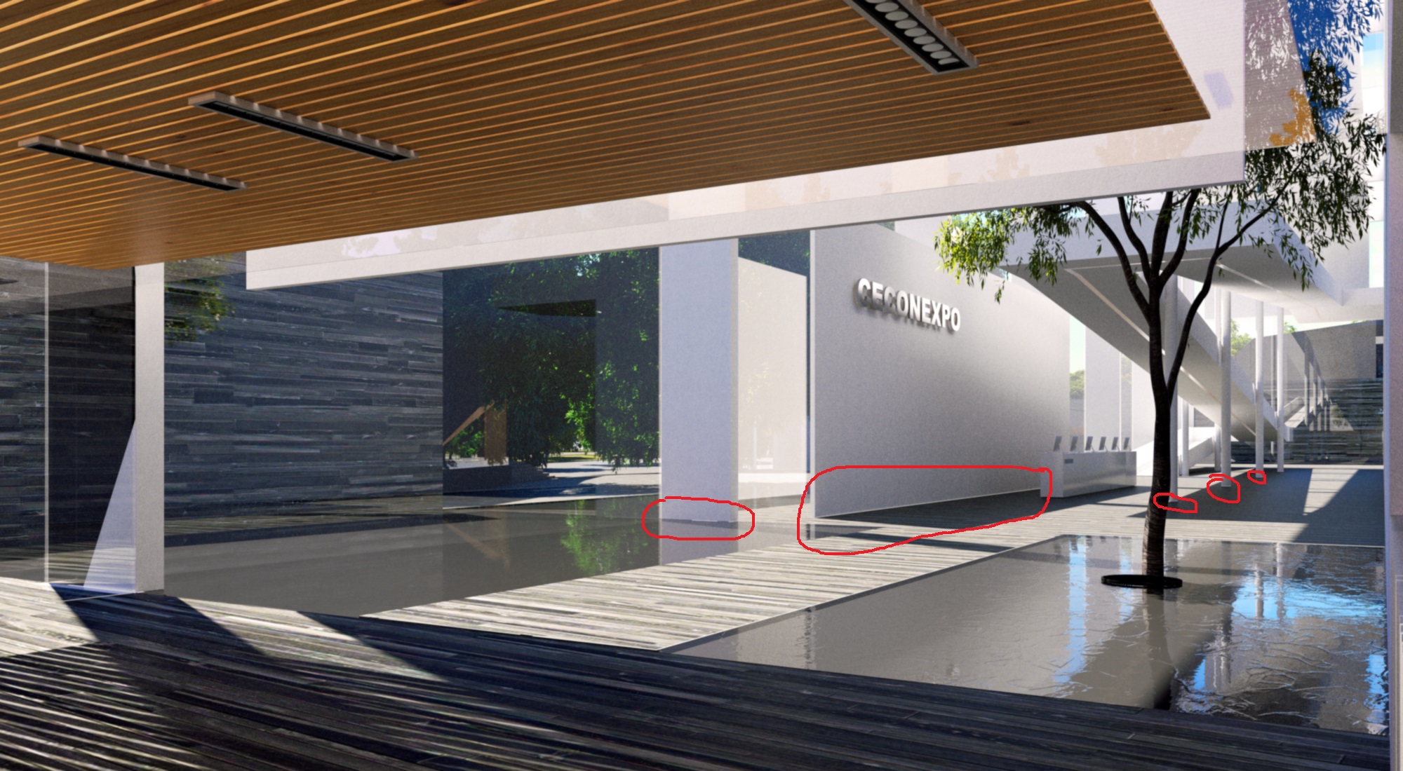

Here is another example of a " bug " in the joints with CPU+GPU
I can deal with brightness variation in the images, but the "light" through some joints i think is a problem :|

Does look like some sort of precision issue.

Maybe obcjects have their origin far from geometry?

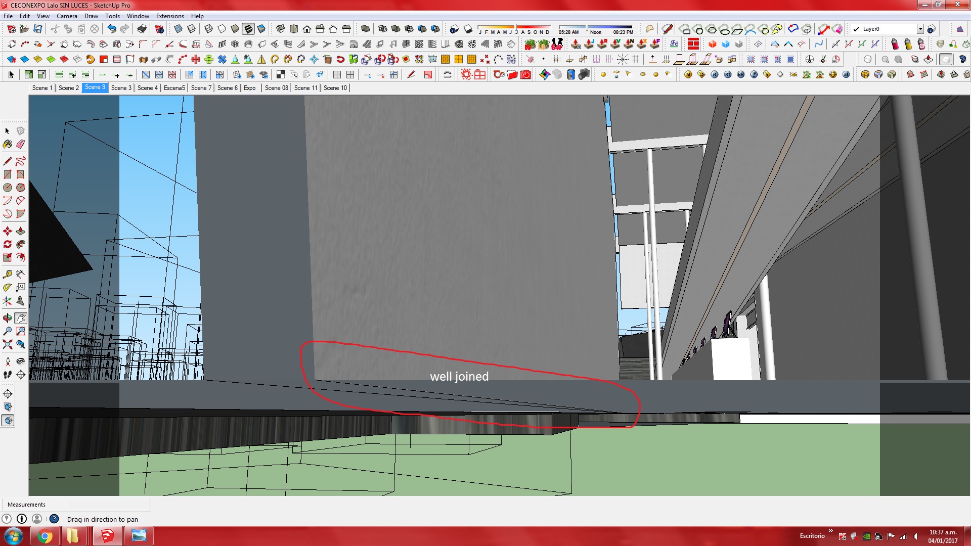

Yes it does look like, but the model is really well done, i can assure you that :wink:

Does adding floor cap at the bottom fix it?

I tried with and without the floor cap and no luck. Only CPU and problem solved :D

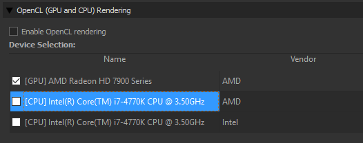

You have no openCL drivers for your CPU installed, otherwise your CPU would be in the OpenCL device list, doublecheck CPU usage during rendering when your Titan card is active and you'll see!

Maybe you could copy these few elements in a new scene and upload it, so the devs have some reduced scene to test while fixing it :)

OH MY GOD!!!... I've been living a lie!!!...I've always thought that by simply checking on the OPENCL feature i was able to render with CPU and GPU at same time. I feel so dumb :x.
Would you please tell me what do i need to do to get my CPU shows up in the device selection? Is an Intel I7 5960X. I would really apreciate your help :D
