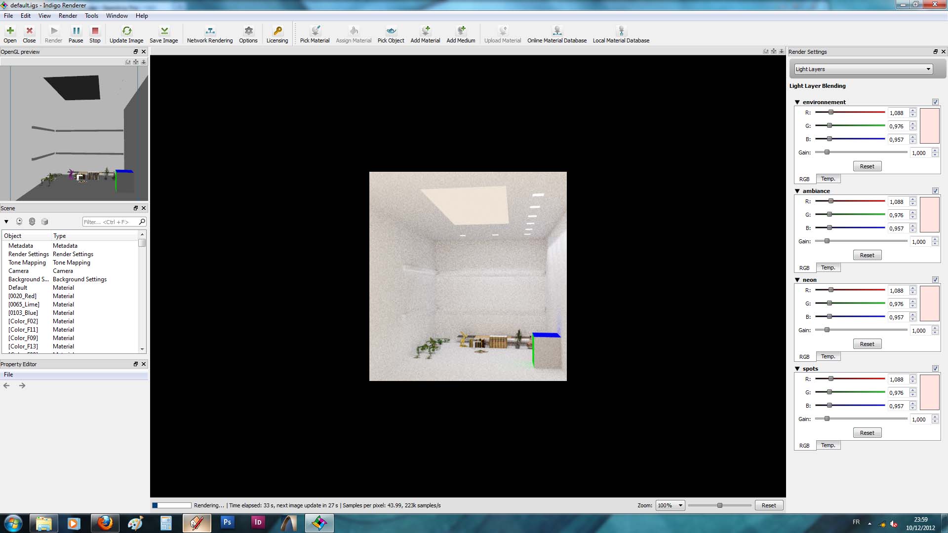

Hello Everyone
i haven t been here for a while because everything worked well untuil this :
I have been trying to make ENV map work with EP and the result is :
WHen i use ENV map and No EP, the scene is correctly exposed
When i use ENV map With EP, the scene is totally Over exposed, even if i set env emission value to 0.00000000001 or anything... same result as image : totally white
(The env map is a texture that is in the model, i will see with a file not in the model; like an exr or hdr external file in another test)
otherwise, with sun + sky, it works perfect.
see joint images (Exit portal is EP layer)
Any clue ?
cheers everyone !

Re: Environment Map can't set together with exit portal?
otherwise, i just tested with other environment settings and it works well.
