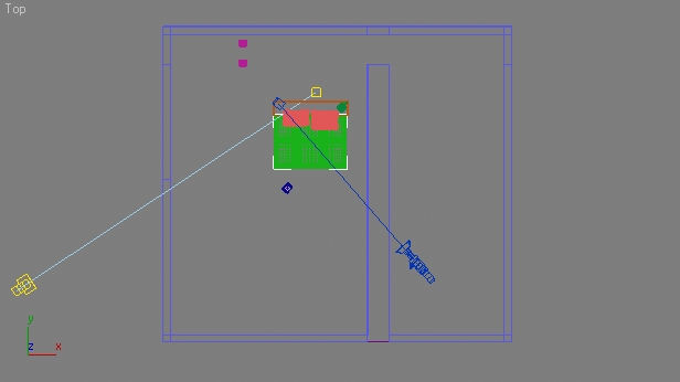

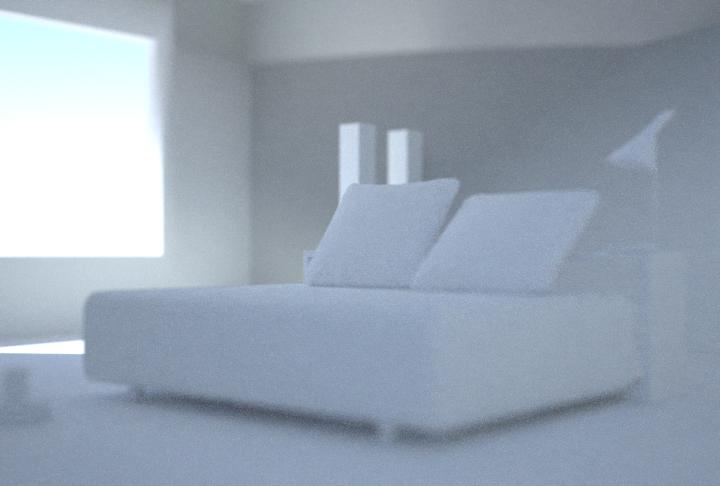

I don't do some image with the camera in the correct position...
as I must setting the camera to have all scene to focus?
I try with autofocus, but the image it's out of focus!!!
setting to camera?
I had already signalled the problem: how I make a material to ceramic of the bathtub?
thanks
max view
vista max.jpg (63.67 KiB) Viewed 1829 times
render view
Post by suvakas » Fri Apr 13, 2007 10:08 pm
Check the scale of your scene. Seems to be too small.

First: if you dont want this to like like a 1cm big bed you'll have to lower the aperture-radius. (or higher the scene-scale)
Second: autofocus messures the distance from the cam to the object in the middle of the image (which is the pillow). Set the focus point/distance manually (dont know how this is handled in maxigo tho :) )
Third: for ceramic i would try a light-grey phong with an ior of ~1.5
hope this helps :)
