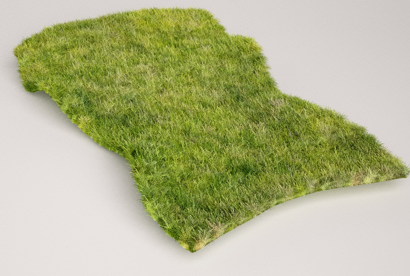

tar_gniK
Posts: 157
Location: London, UK
3D Software: 3ds Max
Re: Public alpha release of IndigoMax
Post by tar_gniK » Sat Feb 11, 2012 7:35 am
Well, in particular, there are some parts of Maxigo Scatter that should be migrated to IndigoMax in some form I think, especially the "Use diffuse map" option. Very underrated IMO. I have used it on numerous occasions and it works very well.
For making a grass plane for example, I would rather choose to use an image map with the variations in colour that I need, and then this would be translated to the scattered object. For this particular task, it is much neater than proxies -- for a nice variation in grass via the proxy method, I am guessing that I would need three or four colour variations of the same grass patch, and then scatter, which would not look as natural.
I have attached examples of renders describing what I mean.
The only negative is that using this method limits you to diffuse only. In addition, the scatter tool only works on mostly horizontal surfaces.
I wish this was developed to a higher level; for trees in example, for a nice colour variation among the leaves, you would only need an image map -- but the script would be clever enough to leave branches/trunk etc alone. This way, you would not need "10 unique heavy tree meshes" in the viewport if colour is the only differentiating factor.
Unless you could use proxies to get their colour from an image map....
