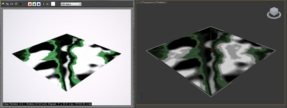

Procedural textures are exported using similar size as they have in Max.
No more need to set noise map scale to very small values like 0,001 or smth like that.

Procedurals were 1 minute fix so I added this in.
